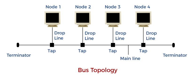

The one thing that I will note to really pay attention to is the recommendation to stick to daisy chaining. We run a bus topology and had no CAN issues on the CANivore until worlds at which there was always one motor on the bus that wouldn’t work (this happened to be towards the end of the loop). CAN FD is sensitive to your can bus topology and I’m pretty sure this is what causes our issue: we replaced the motor 3 times and it literally just wouldn’t work. If that motor connected to CAN other motor on the bus would just flop. Highkey made me pressed bc the fix was to move one motor to the RIO can bus and then later on in the offseason we had to move another one.
I doubt this is applicable to many teams but any teams running bus topology should highkey consider daisy chaining or making your CANivore bus as short as possible.
So unless I’m misunderstanding, when you said you had issues with “bus topology” I assume you mean star topology which isn’t recommended on the RIO bus and from the CTRE docs doesn’t work with a FD Bus due to the higher speed, daisy chaining is line/bus topology.
I’m pretty sure it’s called bus topology? Atl that’s what I’ve seen in networking. Hopefully this image clarifies what I mean if the terminology was confusing.
From what I’ve seen in networking and on wpilib docs, daisy chaining is generally referred to as “daisy chaining topology.” Bus topology is lowkey weird term in the sense that it can refer to the actual topology as shown above or it’s just a vague term used to label your overall can bus topology (whether it’s daisy chaining, star, ring, bus, etc.)
You are right in saying it’s not suited for CAN FD because of faster transmission times. We thought we would be fine running bus topology if we just kept our stun lengths short but as I mentioned above bus topology can cause some p funky problems if your loop is too long. How long is too long is a question I have yet to find the answer to.
This only applies for CAN FD tho. Bus topology on the RIO has always been fine for us and is largely preferred so one device doesn’t take down the whole network.
Interesting, I was using this for reference:
From my understanding that picture for Line/Bus is the same as your Bus topology which is the same as “daisy chaining” as the CAN H/L pins from each device are just shorted together. So the “drop line” is just the trace from the pads that the green/yellow wires are soldered to to the microcontroller in the talon.
