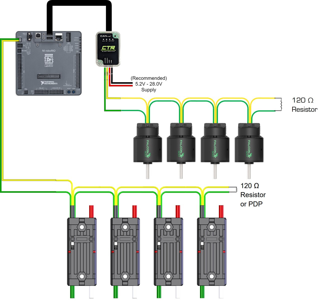

We bought 2 CANivore’s for use with our swerve the next season. Our swerve has all CAN FD compatible products.
  • 8 falcons
  • 4 cancoders
  • 1 pigeon2
The original CAN bus works fine on the RIO. We switched the CAN bus over to the CANivore and it did not work. CANivore does connect to the rio. After some messing around we found we can connect about 5 devices at a time and any more causes it to stop working. We are using the internal terminating resistor and wago lever nuts for all connections.
What is your CAN topology like? How long are your branches?
Do you have a termination resistor on the other end of the CANivore bus? CANFD definitely needs both ends terminated to work well

Topology is standard daisy chain. Branches are 6’’ to 20’’ short for going between devices on a module and long for going between modules. Ultimately we want to shorten and clean stuff more.
Would the internal resistor on the PDP be suitable for this? I don’t know if being a non CAN FD device is a problem. Otherwise I don’t have one on hand right now.
So with a standard daisy chain, only CANFD devices (no PDP/PDH, only what you listed) and if there is a 120 ohm resistor between CANH and CANL at the far end of the bus from the CANivore, then the only other thing I can think of is maybe you have a bad connection somewhere. Bus topologies and connections that worked ok at normal CAN speed might have problems with CANFD if they’re flaky.
The PDP doesn’t work on CANFD. That’s your issue, no 120 ohm terminator. CANFD is very picky about that. The bus might work if you don’t power up the PDP, I’m honestly not sure though. Depends on how CTRE built it.

Finally got a 120ohm resistor yesterday and it solved the issue. Thanks for the help.
