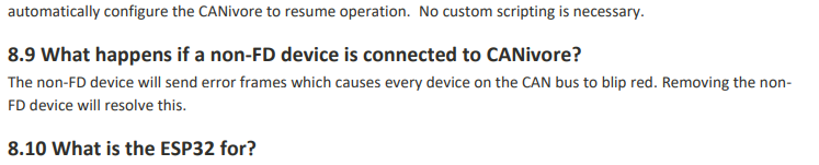

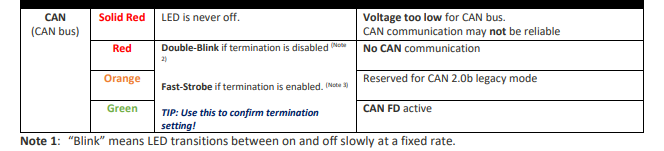

This i what I found in the manual.
Well, on the manuel it says “no CAN communication” but in our robot there is a can communication. It works as we expect. The problem is every CAN led on our robot blinks red (sometimes roborio blinks green as well)

Sorry I misread your post and thought you said stayed red not blinked red. Is this applicable?

Unfortunately not. It doesn’t have a non-FD device and It also blinks red when I connect it via Computer and remove every device from the bus. (Computer-canivore-resistor circuit)
Is can termination enabled for the Canivore?

I did check it with can termination on and off. It doesn’t change the behaivour of the canivore

Solid red for the Canivore can light means the bus voltage is to low. I would fix that first. Although the manual says it it optional, I would power it from the aux power. Or maybe you canbus is shorted somewhere.
Are you using a 120 omg resistor. We were having some issues with this before as well and it was resolved by using a 120 ohm resistor instead of using the pdp or pdh. Also make sure you have only CAN FD products on the CANivore network (Falcon 500, CANcoder, Pigeon 2 and CANdle)

Oh, i will try that but is 775pro a CAN FD product? just wanted to be sure.
775Pro is a motor and has zero CAN capability. What controller is driving the 775Pro?
The only CAN FD products are a CANdle, Falcon 500, CANcoder and a pigeon 2. Any other devices can not be on the CANivore network and must be on the regular rio network
