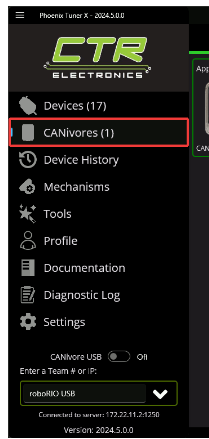

When you control a motor in USB mode (see screen shot below), we also see them blinking red. When you actually control it via robot code they blink normally (at least this is our experience)
it is connected with usb to the roborio
i will check what happens if i am activating the robot via code

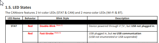

per the docs https://store.ctr-electronics.com/content/user-manual/CANivore%20User’s%20Guide.pdf
Also be sure to turn this off if you intend to operate your motors via code:
update we can control the robots via code but we dont get an indicator via led light on the robot on witch way they are turning its only blinking red
