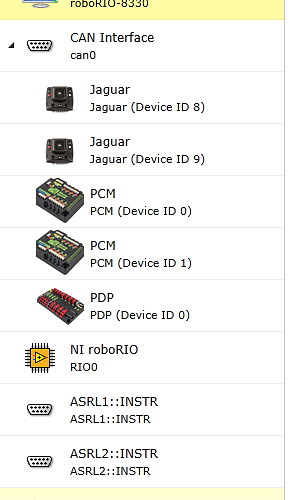

Have you checked to make sure that you can see that CANJaguar using the roboRIO webdashboard?
I am having problems finding out where to get that. Does this screenshot make sense for you?
http://puu.sh/eEcav/f85f6c8588.png
If the jaguars were properly connected, they would show up under CAN, like attached.
It does and it indicates that your roboRIO sees no devices on the CAN bus (or you took it shortly after boot-up and you need to refresh the page).
Check your CAN wiring (I would try taking the Jags out of the chain and wiring from roboRIO to PCM if used) to PDP and see if you can get at least one device to show up, then start adding Jags to see where the cabling issue is.

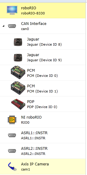

We have tested, found and then replaced a wire that was stopping CAN as a whole, and now we are able to connect to the PCM and PDP, but the jags are still not being recognized. Here is a screenshot of our CAN connections:
http://puu.sh/eEuXx/a318618a2d.png
We arenโ€™t sure if this is a firmware problem but we installed the version from the update suite. The version number is 2.1.0f3.
