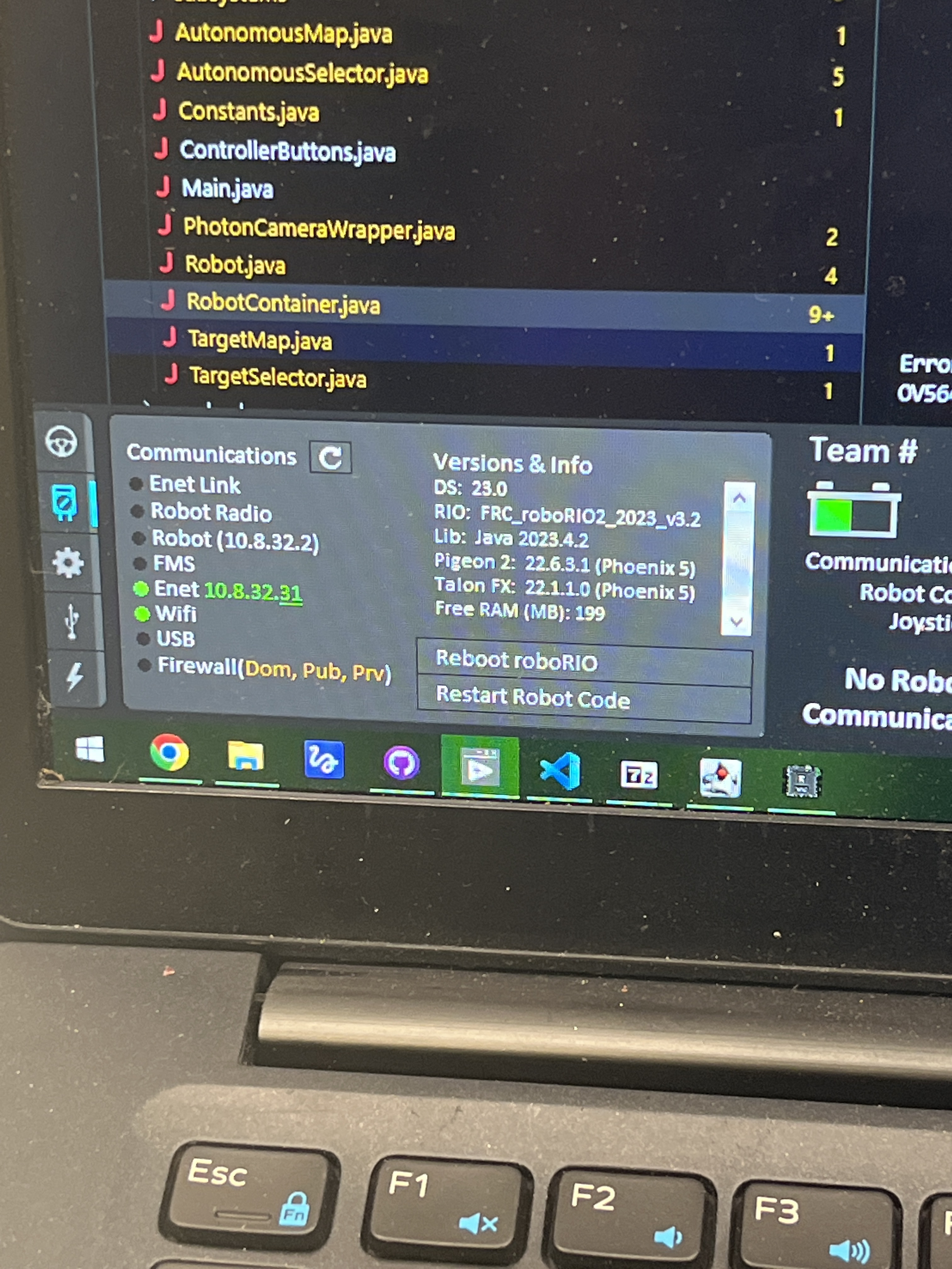

Does driver station show comms? If so, could you post a picture of the connections tab within driver station?

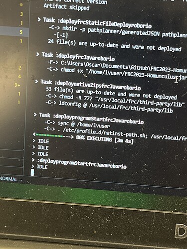

Strange…I slept on it and now it executes the code when tethered, meaning it can be enabled. However, it remains on 80% while executing and won’t change past that. We reset the RIO and it didn’t have code on it but now shows green in comms, meaning it is being sent. Here’s a photo for reference:
I’m assuming your code works just fine over wifi, and builds with no errors.

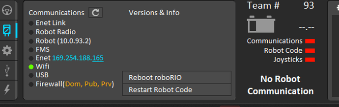

Side note, while you have driver station up: could you post an image of the connections tab?
It is the second block on the left side of driver station.
Should look similar to this.

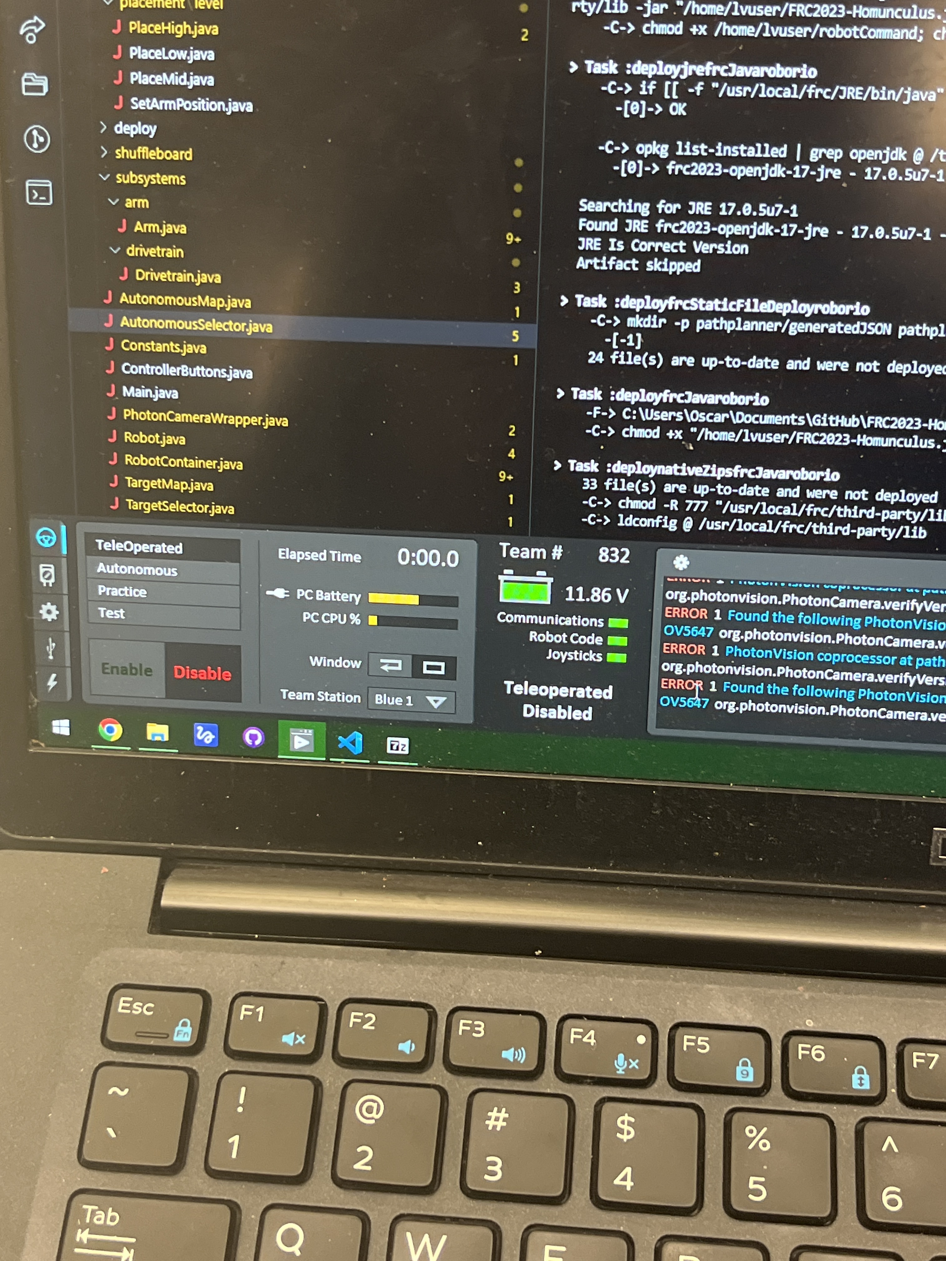

It’s very fickle now, so it may be an issue with the ports on the hub or an Ethernet possibly. I reset the RIO after it stopped connecting when changing the battery out, and now the build is successful with the Ethernet. I realize there’s a version issue with the driver station so I’m trying to update it currently, but here’s a photo nonetheless:
