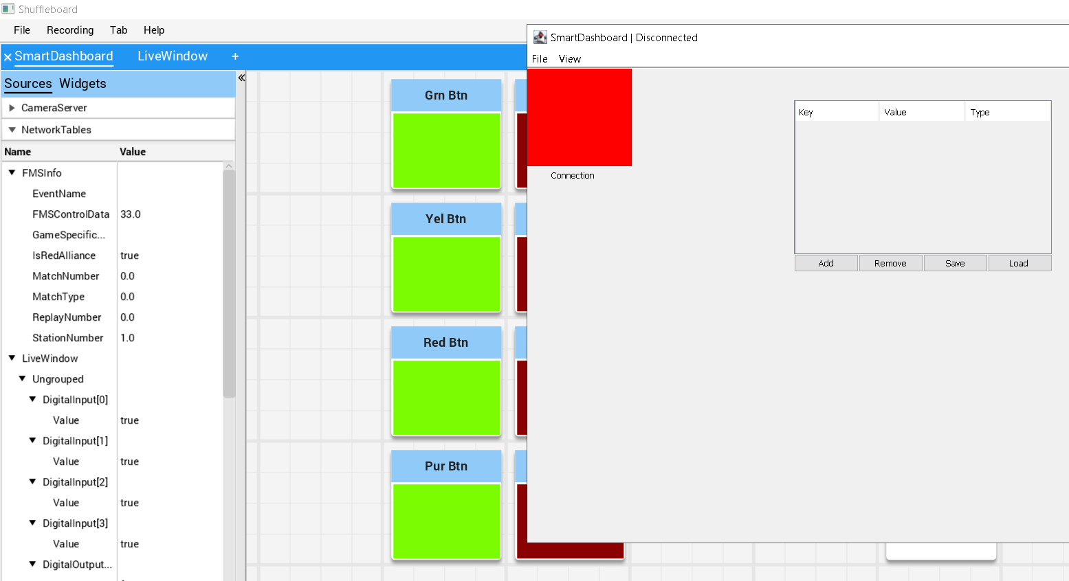

Cannot get SmartDashboard to run with Simulator but Shuffleboard does
I can launch Simulator and then Shuffleboard and I can see the SmartDashboard.getxxx stuff, LiveWindow and FMSInfo. However, can’t get anything on SmartDashboard, even Connection shows Red.

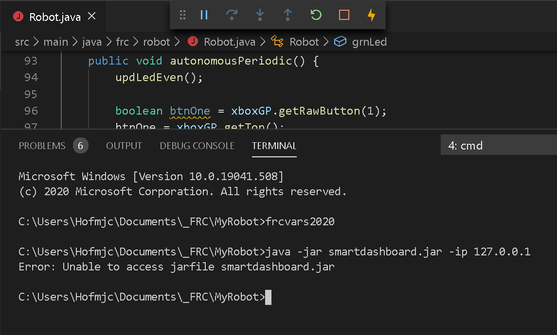

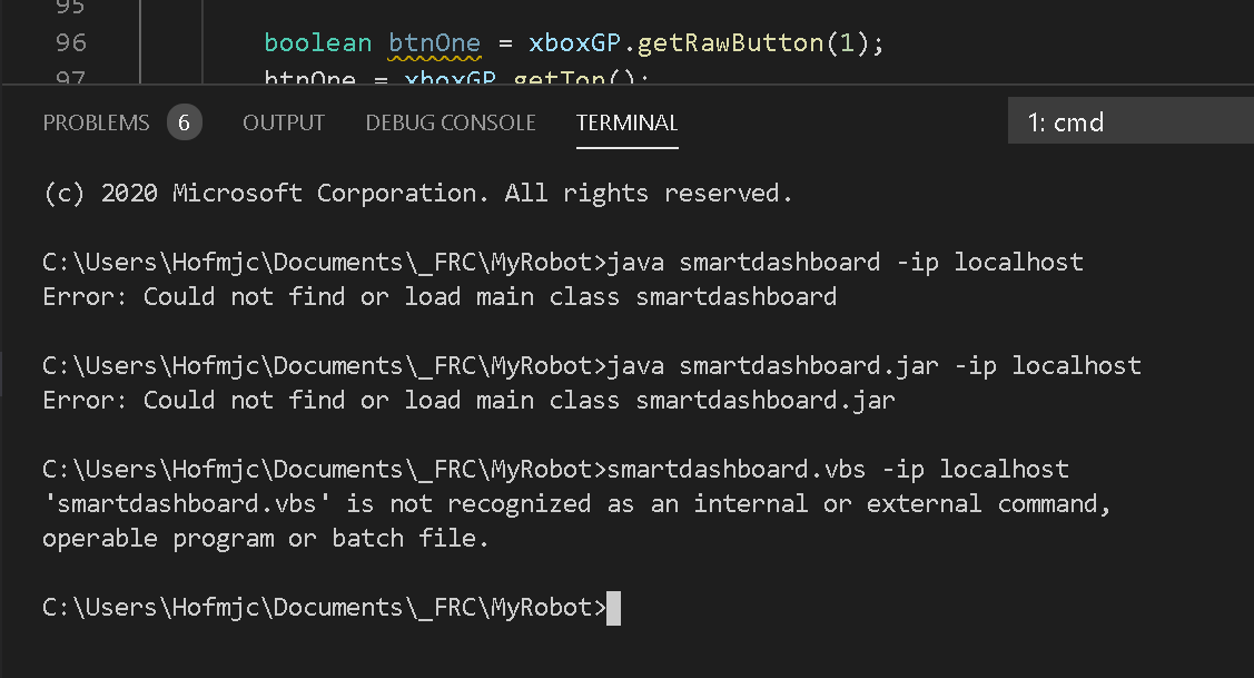

I’m running VS Code. There is no WPILib Simulator with SDB. I’ve been launching SDB from the desktop icon which is linked to a VBS.

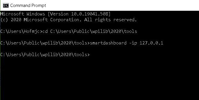

I tried to launch from the terminal and it can’t find it. I openned a cmd window cd’ed to tool directory and launched it there with the -ip localhost. Same result. Wierd part is Shuffleboard works just fine.

Did you launch the vbs from cmd, or the smartdashboard jar?
Not sure what your suggesting. Here’s what I tried.
I launch it from a Windows cmd prompt.
And here’s SDB & Shbd
Just not sure. Thanks.
You’d need to type
frcvars2020
And then type
java -jar smartdashboard.jar -ip 127.0.0.1

I’ll take your word on that but here’s my results. :sweat_smile:
Like I mentioned, not a big deal as long as Shuffleboard is working. Might be something I’ve loaded on my machine. More curiosity then anything.

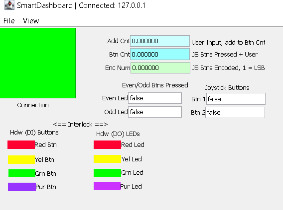

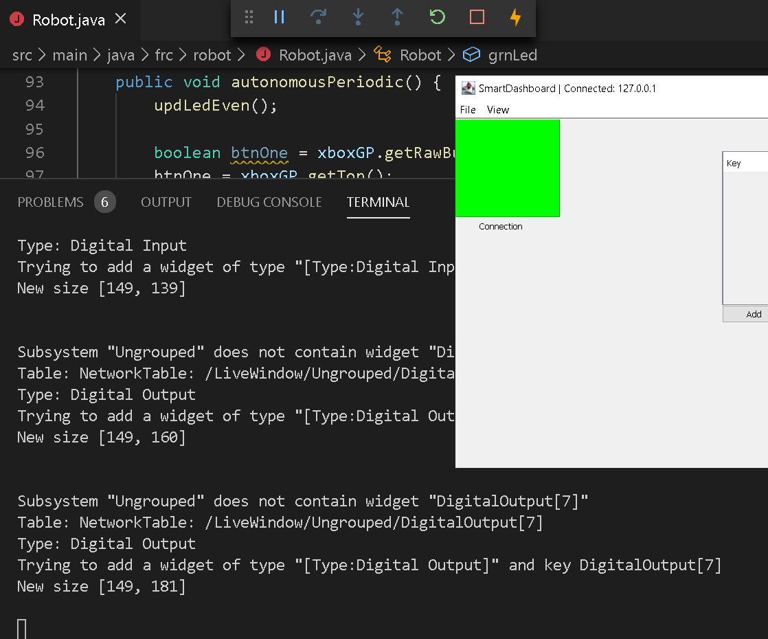

Sorry you need to be in the tools directory. C:/users/public/WPILib/2020/tools
HEEEYYY!!! :smile: :star_struck: :crazy_face:
lol. Thanks. Owe you one!
