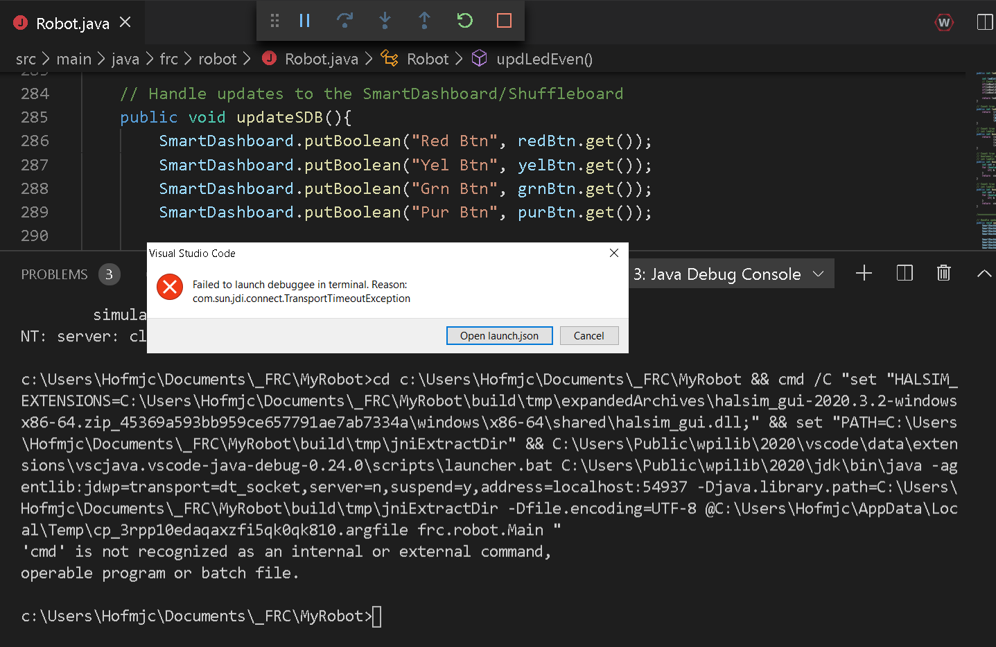

I can start the Simulator and it works. However, I close it, with ‘X’ or the Red close button, after that I get an error if I try to launch it again. I was closing 2020 FRC VBC and relaunch. It worked again.
I found I can Kill the Terminal and it starts a new one. The Simulator will relaunch.

I’m using it for some noobie training. I have 2 projects I’m working with and both are doing it. They only have 4 DI’d & 4 DO’s, 2 Joysticks with getRawButtons. And a bunch of SDB mappings.
Not much. I might try creating a new Project and add shtuff 1 type at a time.
I see it also when it throws an error asks to open launch.json. Might compare old to clean.
