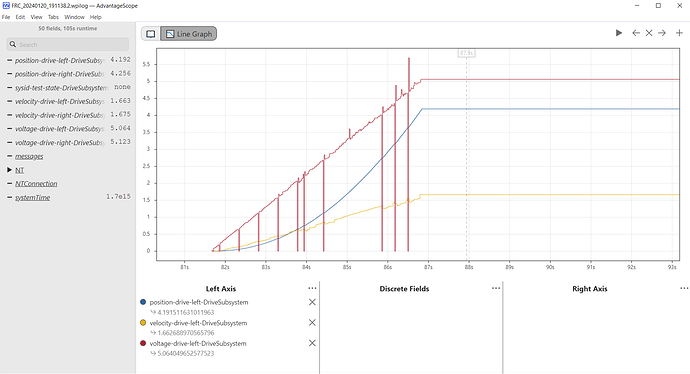

We are trying to use the Sysid tool to characterize our robot for Path Weaver. Once we ran the Quasistatic & Dynamic tests, we tried to load and analyze our log files but we receive the error above. I have uploaded one of our data logs below. Any idea on how to fix this?

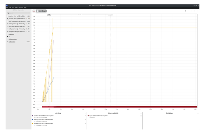

Here is a graph of our data.
The log you provided only shows quasistatic forward data.
Yeah, none of the tests were able to be analyzed and they all had the same error. I just added the Quasistatic Forward log as an example. I wanted to see what a potential cause of this error might be.
You need to have all 4 tests in the same log
