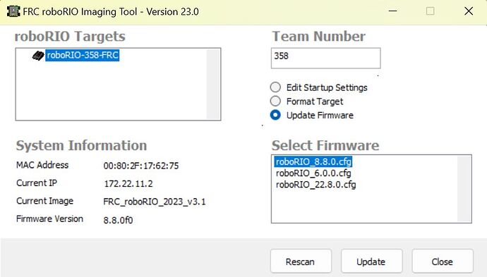

We’re using RoboRIO 1, firmware 6.0.0, and image 2023_v3.1. We’ve connect to the RIO (it appears in Phoenix Tuner), but we can’t deploy code, we don’t don’t have comms, and we aren’t detecting the CAN chain. We can’t access the robot through driver station.

Firmware for a Rio 1 should be updated to 8.8.0
Where do we get the files for the 8.8.0 firmware? Did they come with a game tools update?

They are packaged with the current year game tools.
If they’ve been installed you can find them under:
C:\Program Files (x86)\National Instruments\Shared\Firmware\cRIO\76F2
Hmm, I still only have 6.0.0. Is that only a RIO2 thing?
Not a RIO 2.0 thing as the RIO 2.0’s use firmware roboRIO_22…
Something odd about your software installation.
If you want you can try placing this (unzip it) in the 76F2 folder to see if the roboRIO Imaging Tool finds it.
roboRIO_8.8.0.zip (25.3 MB)
