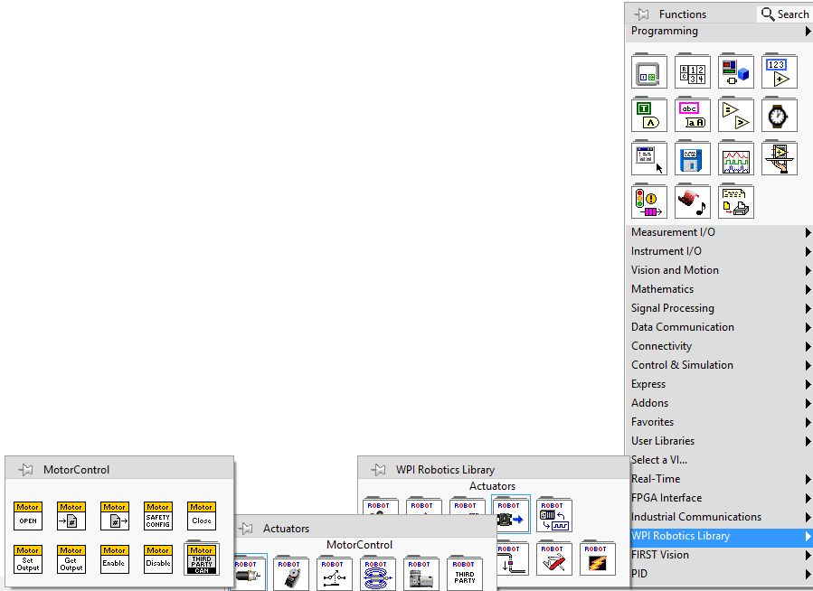

cant find motor in labview
Can someone please assist me on finding the motor icon in labview i cant seem to find it and i have looked every where.

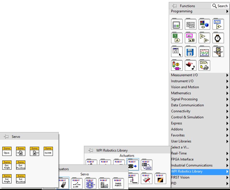

we are trying to program our servo.
The first attachment shows were the servo palette is.
The second attachment shows where the motor palette is.
thank you for the help but we do not have WPI robotics library on our labview do you have any other suggestions?
You need to install the FRC Update Suite from the NI website: http://forums.ni.com/t5/FIRST-Robotics-Competition/FRC-2017-NI-Software-Setup-Guide/ta-p/3565941
Install the FRC Update:
http://www.ni.com/download/first-robotics-software-2015/5112/en/
Directions here if you haven’t seen them:
http://wpilib.screenstepslive.com/s/4485/m/13811/l/144150-installing-the-frc-2017-update-suite-all-languages
