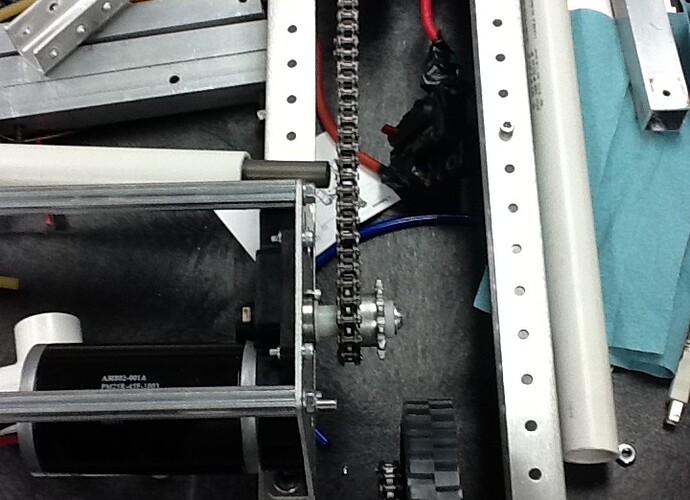

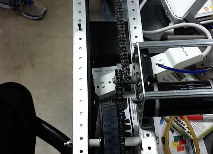

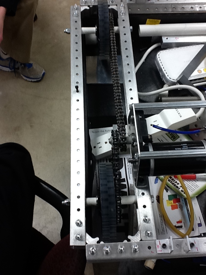

We are trying to build a wide 4 wheel drive using the kitbot. For some reason even though the chain lengths are the same they fight correctly on one side but on the other the back is too tight by only a little bit to put on. Any ideas why this would be? Pics attached.

Thank you guys for your answers. Let me give just a little bit more information than was initially given, however, to possibly better explain what we have going on.
It appears to not be a chain length, nor is it a fastening problem. When setting the chains, they are so tight on one side that it bows the wheel inward on the offending side. The other side, using the exact circumference of chain, it is slightly loose. This is true no matter where one slides the gearbox.
I have counted the links, the teeth, and measured the circumference of the chain and found both sides to match each other within a measurable tolerance. However, even though all major variables regarding the chain and distance are the same, we are off by as much as a quarter of an inch when inserting the last screw. I would say it’s a squaring issue, however, both the left side and the right side of the drive train have nice strong squares holding them in place.
The only real possibility I can find is that the height of the sprocket is off by 1/8 of an inch or something is wrong with the installation of the gearbox. Can you install a gearbox incorrectly or is it very much so built to prevent any kind of user failure.

Is it just me, or does the left rear wheel look like it’s out of alignment with the frame?
The axle holes in the C-Channel aren’t exactly in the center of the channel. When you assemble everything, this means the holes are closer to the top or bottom of the frame. One or two of the channels on your tight side might be upside down relative to your loose side. The easiest visual check is to look at the one hole that’s out of line with the rest. Make sure it’s shifted in the same direction on all your channels. The correct direction is probably down, which puts the rest of the holes closer to the top of the frame.
My oh my that would do it. We’ll check that tomorrow.

I would check the sprockets on the wheels themselves. On our robot the sprockets that come in the kit don’t always match perfectly. So when rotating the wheels there will be a tight spot and a lose spot. I would try to rotate the wheels to see if the sprockets are in perfect alignment. I just did our chains yesterday and I fought the chain on to the robot (not an easy task). Hope this helps.
