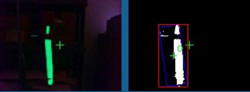

I think this is what you are describing as faulty and what you desire. I couldn’t get my LL with PV to connect to the browser (of course it worked the last time I had it on)

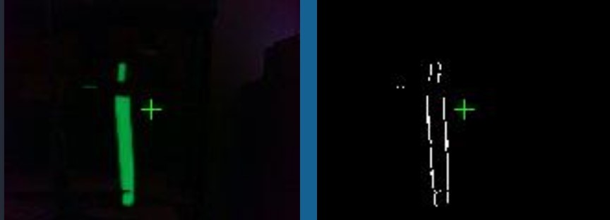

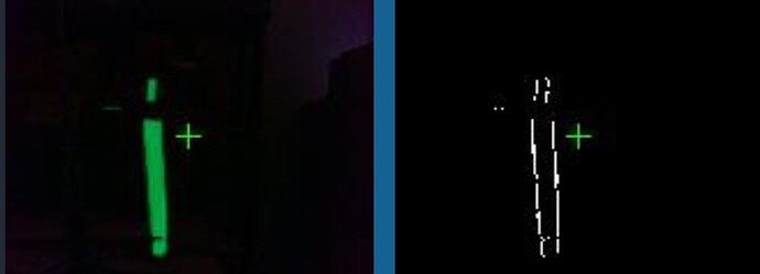

but here’s what I see on RPi PV. In this instance the HUE range was the tiniest bit too tight. (Obviously not the game poles just two pieces of tape hanging on a box in my basement. The little dots between the large tape and smaller tape is the model of the 2022 hub high target still available for use.)
And there is a lot of jitter with just an outline detected.
Yes. My input looks like your upper left picture though much smaller since the targets are smaller. The picture on the upper right is what one would expect. I had to work hard to get a processed image that looks like your lower right picture. The red outline never appears and the target identification with target number is constantly flashing as it ids the shape as a target and then changes its mind.
