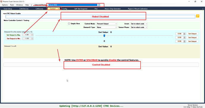

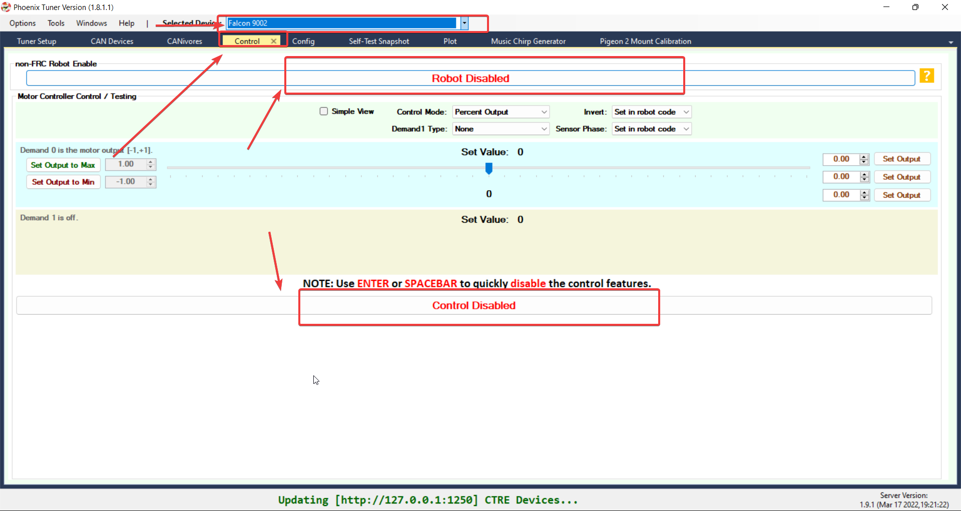

EDIT: Note that if the device is connected to a roboRIO, you’ll probably have to use the driver station to enable control anyways, since the device will automatically go into a FRC locked state.
An easy way to verify that the motor itself is working properly in closed loop, is to factory default the motor and then attempt to control it using Tuner. Alternatively, you can skip factory defaulting and just enable via driver station.
  1. First, navigate to Config and ensure your device is selected at the top dropdown box. Then press the Factory Default button at the bottom. This will reset your device to default. Alternatively, you can just enable your robot in driver station.

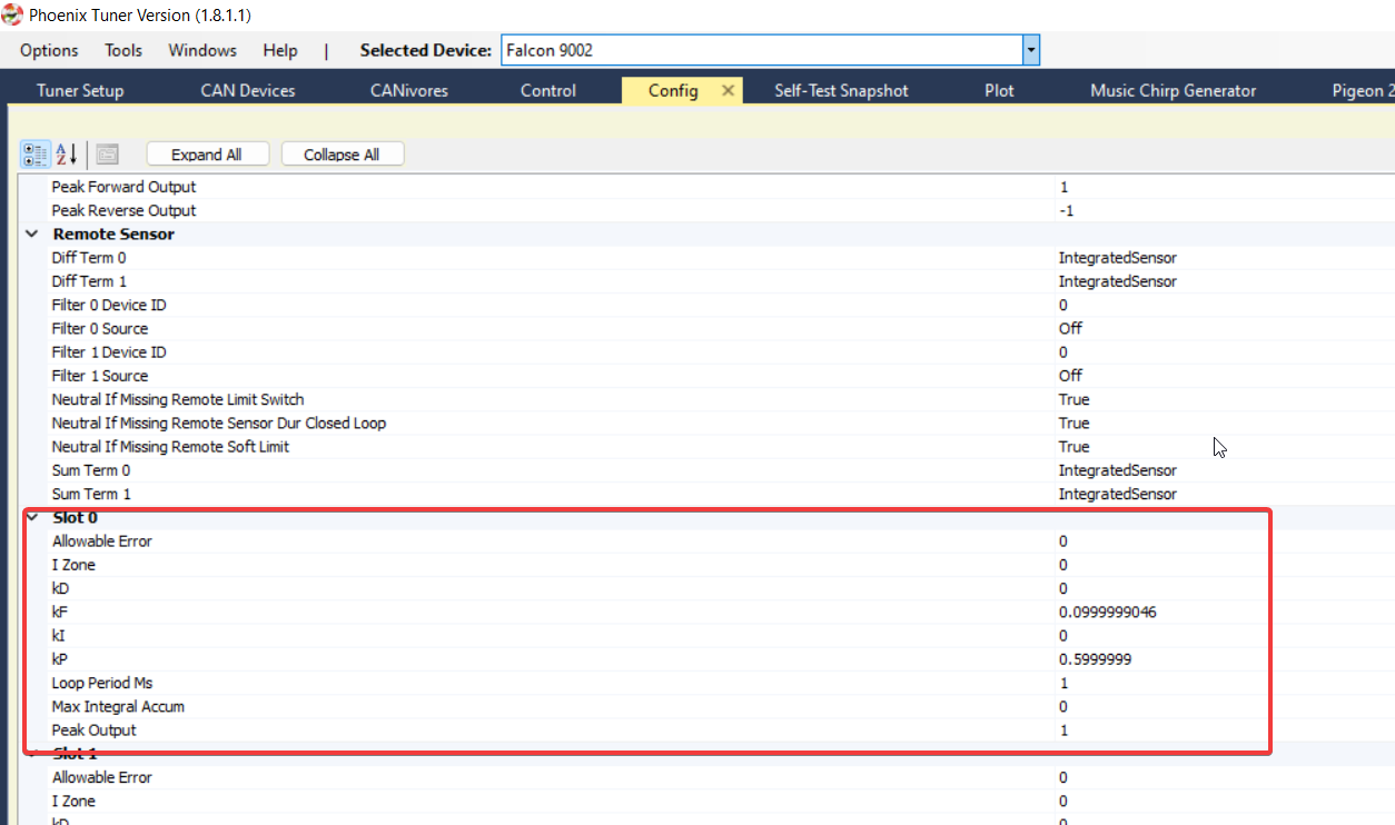

  2. Now configure your gains under Slot 0 (that is the default slot unless you changed the slot)
  1. Now navigate to the control page. In the middle of the application is a drop down button labeled Control Mode. Change that to Position. If you factory defaulted your motor, then ensure you press the top Robot Disabled button. If you didn’t factory default, open driver station and press the “Enable” button. Lastly, just press the bottom button in Tuner that says Control Disabled. Verify that the motor is attempting to reach it’s set point.
If none of the above works for you, I’d send a support request to CTRE with a Self Test and a copy of your device Config attached.
