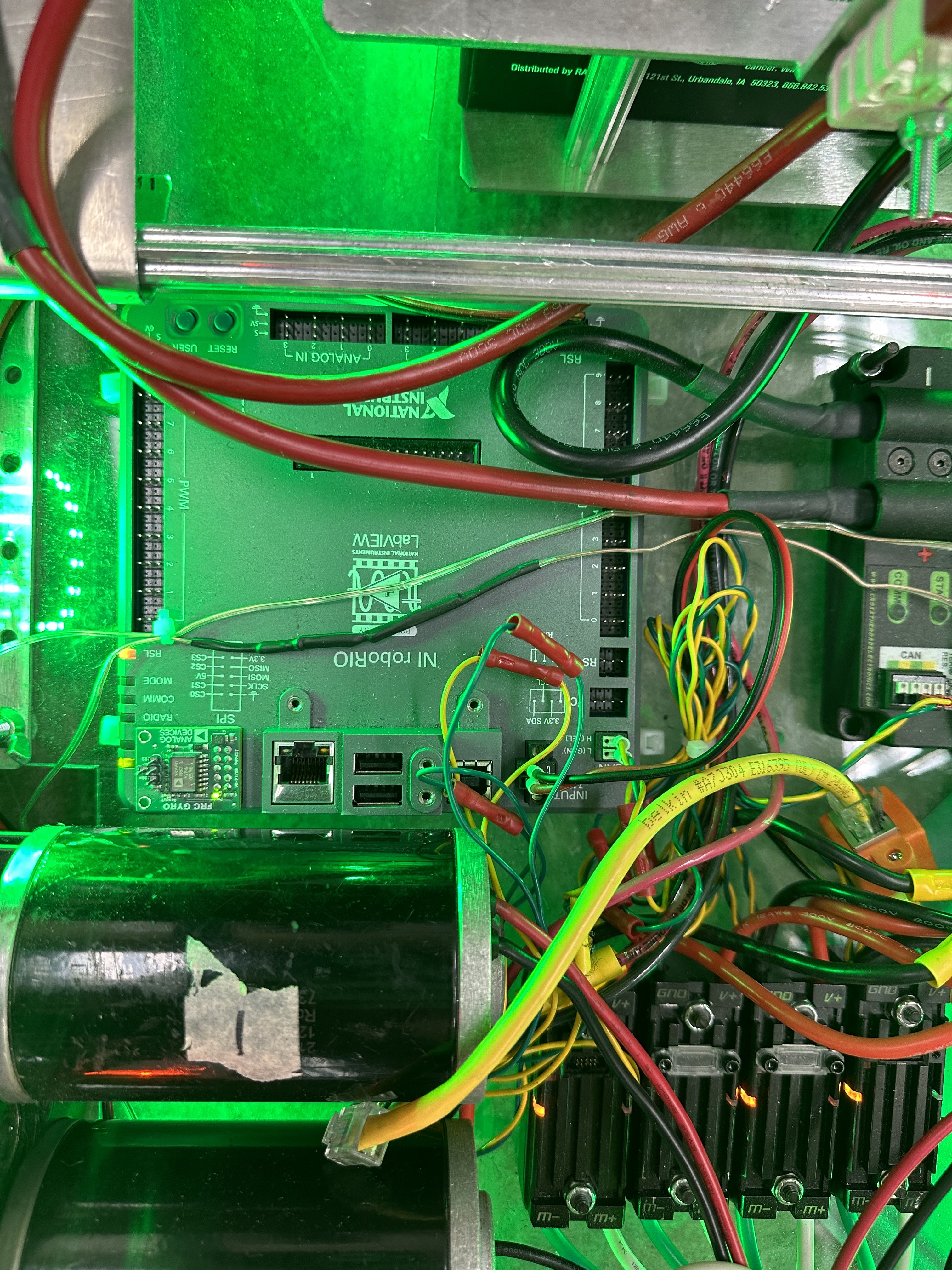

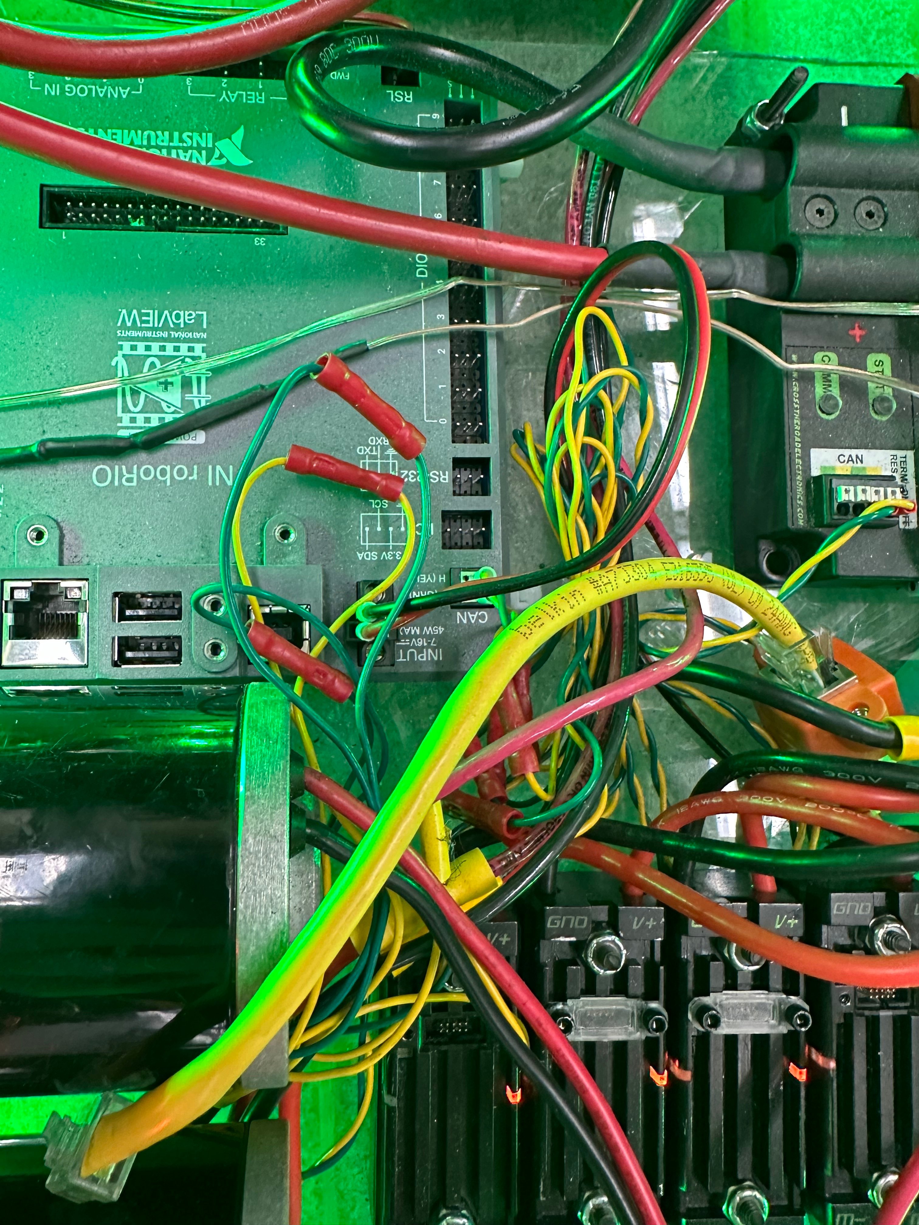

Some photos of the robot if that helps
If this RIO has never been imaged, you will not be able to deploy code to it, so your first priority should be getting the imaging tool to succeed. Have you connected the RIO to a laptop using the USB-B port (square port next to the power input), and attempted to locate it using the Rescan button on the roboRIO Imaging Tool? Also, what version of the FRC Game Tools do you have installed? A screenshot of your roboRIO Imaging Tool window would be helpful. If you have not already, try installing the latest version of the FRC Game Tools on a different computer and using that to image your RIO.
(side note: your roboRIO is not connected via Ethernet to your radio; is this intentional? to be able to deploy code over a Wi-Fi connection, you will need them to be connected)
Based on the image in your first post:
I think this is referring to a problem with your computer’s network settings. Can you open a command prompt, run the ipconfig command, and share the output?
