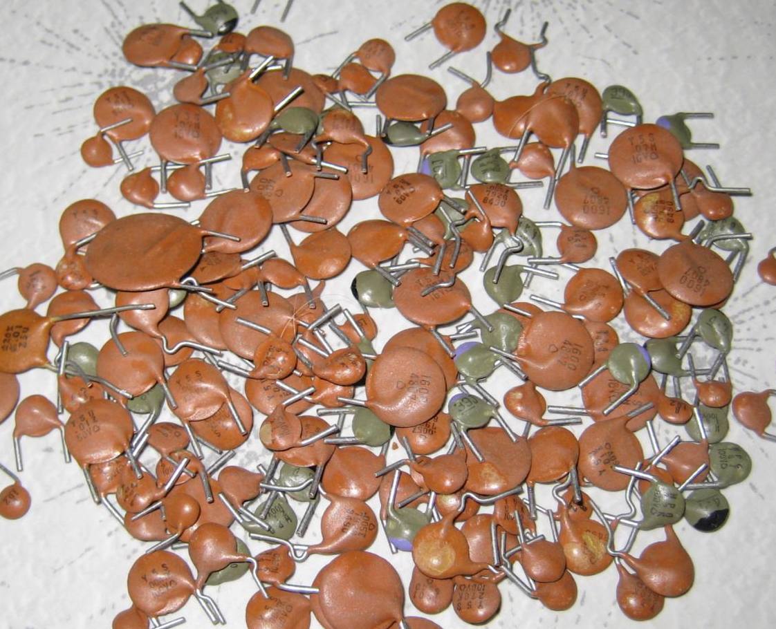

I got a bag of capacitors from radioshack, but I am not sure how to read the values on them. Instead of having a three digit code on them, some only have 1 or 2 digits. Some have “10” on them and others have “7” on them. Does this mean missing 0’s or something else?
These are all ceramic.
A real small one that says 10 might be 10 picofarad.

My problem is I only have 2 numbers. The normal code has 3. Most of these caps only have 1 or 2 numbers on them. I am wondering if the other two can be assumed as 0 or what. They are ceramic, so there is no color code. There are no letters either. I have ai or 2 digits and that is all.
That is correct, but he has caps with one and two digit ‘codes’.
If they are physically small - say, the size of a lentil or smaller - that could be the actual value in picofarads.

I found this webstie finally
http://www.ehow.com/how_4480564_learn-read-surface-mount-capacitors.html
specifically this paragraph
“Learn to read 2-digit capacitors. Ceramic disc capacitors are often labeled with just two numbers. if the value is less than one, these capacitors are generally measured in microfarads. If the value is more than one, it indicates a value in picofarads. For example, a capacitor that reads “.01” will have a capacitance of 0.01 μF (microfarads), or 10,000 pF (picofarads). A capacitor labeled “15” will have a value of 15pF.”
odd. I ahve never heard this before. Thanks for all the help

Although the two digit code represents picofarads below 100, don’t be fooled by a marking that is obscured or rubbed off. Use a bright light and if the cap is dipped in parafin, the last digit might be under a drip.
