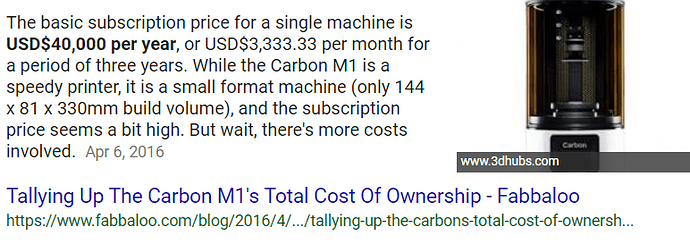

I’ve not used a Carbon printer, but I was curious about the cost.
I just googled this up–is this really right? I can’t imagine our team ever being able to afford $40k/year for a ‘subscription’.
Yep, see BeardyMentor’s post above.
I don’t really see our team ever having the budget for something like the Carbon either. FRC and schools aren’t really the target market for their printers.
