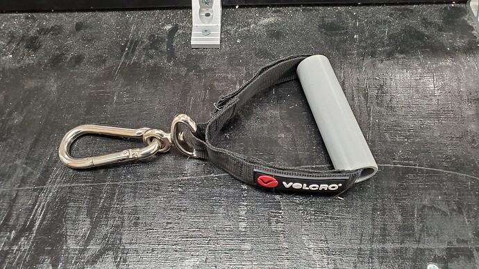

We also use four eye bolts at the frame corners and lift handles made from these Velcro hang straps. We looped them through 4" sections of 1" PVC conduit. It makes for a solid and secure handle that’s pretty much the perfect size to lift with and the carabiner clips on and off quickly while the swivel lets you position your hands for the best lift angle. Here’s a pic of one of our lift handles:
These are not slick built-ins, but they definitely make it easier for students to lift the robot. We just sling them under the robot and separate them until they’re near the wheels at the 4 robot corners.
