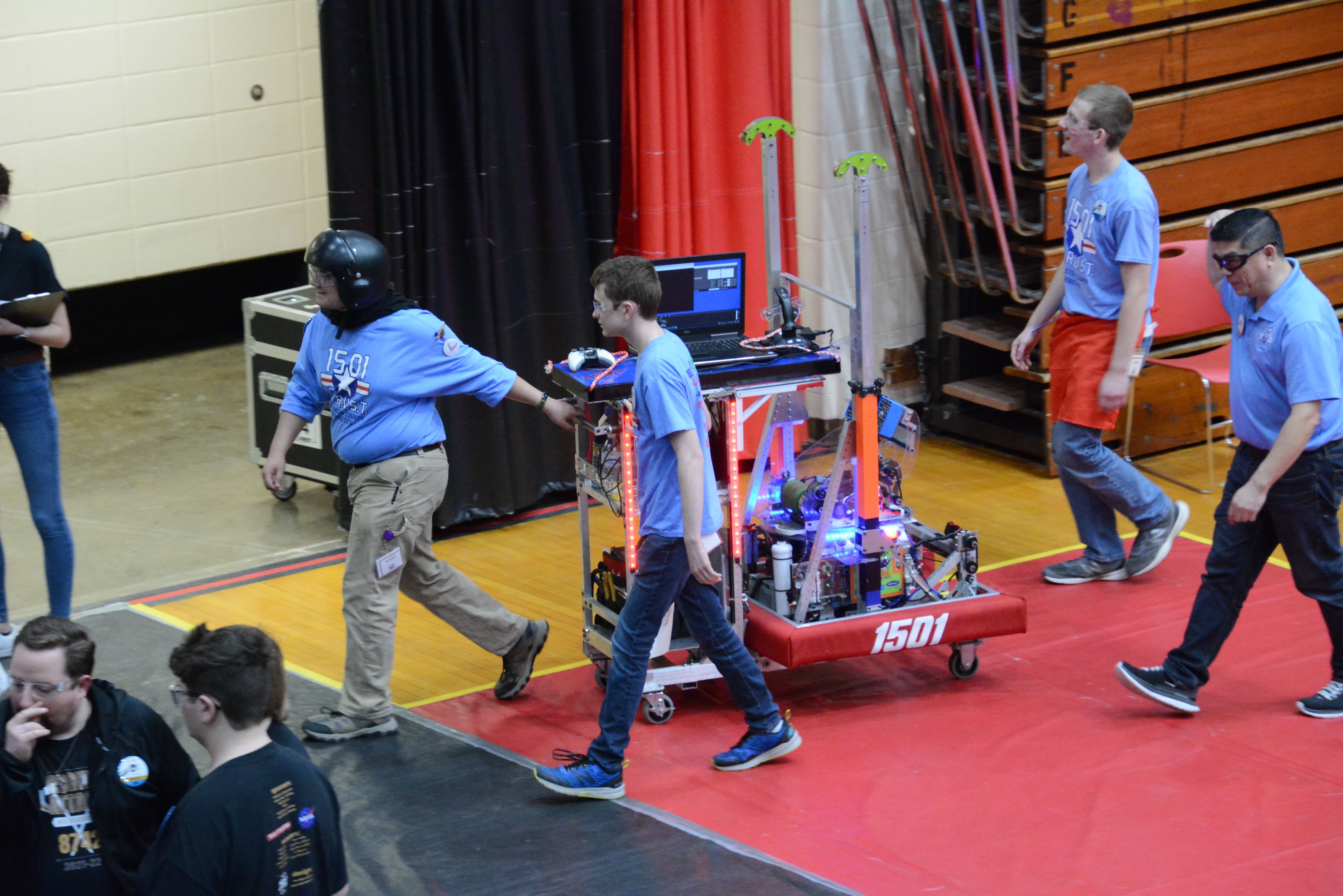

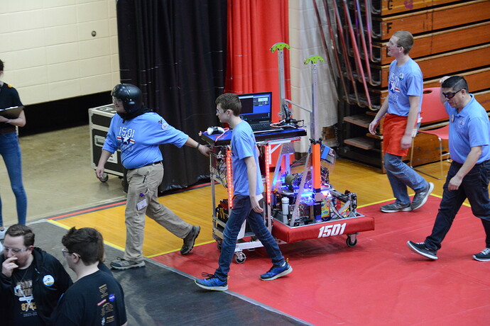

Here is our current cart.
We set the LED’s to our alliance color.
Also, the part that the robot sits on flips up for easier storage.

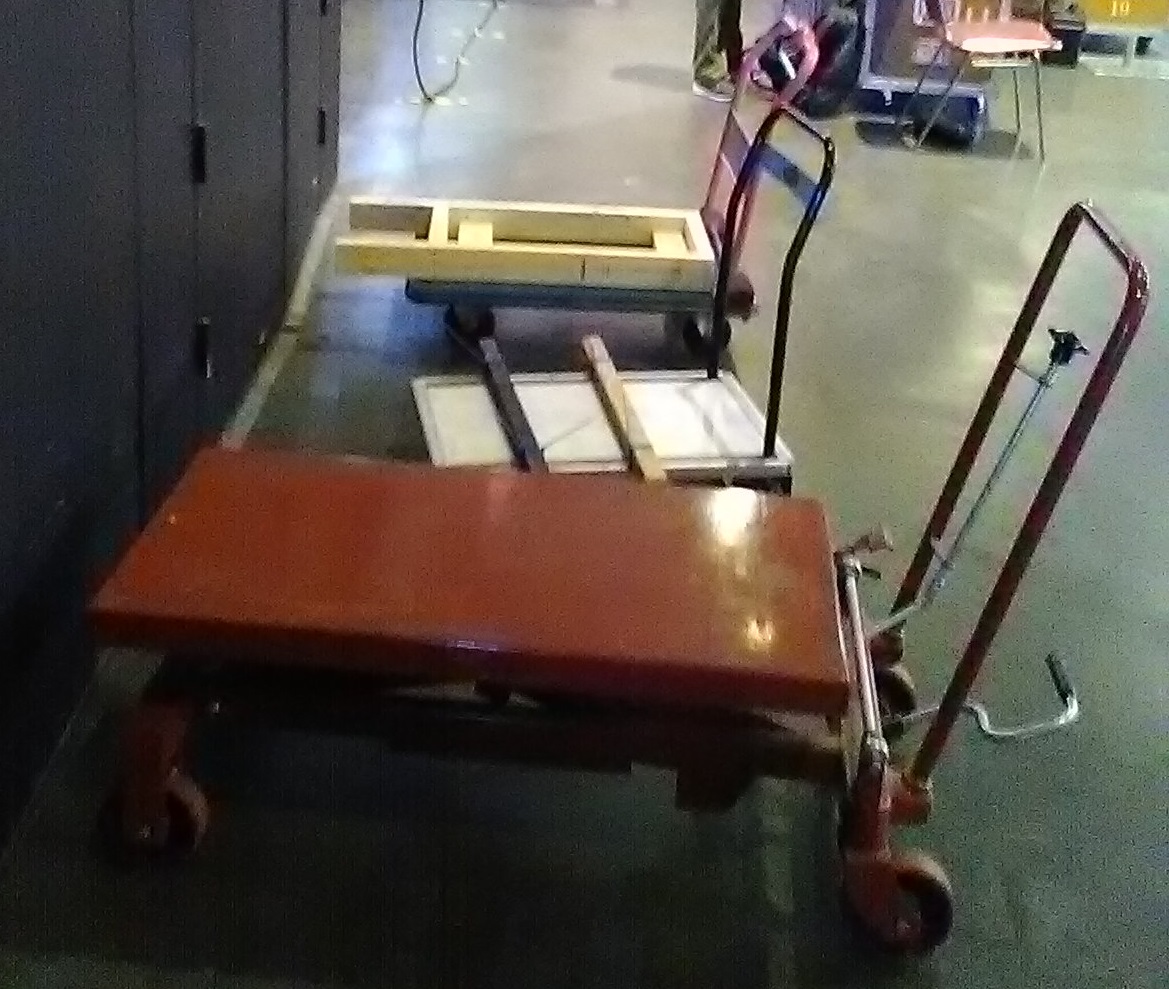

How curious … I was queuing at Bayou and on Friday I saw these three awesome carts:
IMHO, a robot cart should:
  • Support your robot so that the wheels are free to spin.
  • Not be much larger than your robot in either dimension, especially width as the cart travels so you can fit through doors.
  • Be relatively low to the ground. Your robot on the cart should never be taller than 6’8," again to fit through doors.
  • Be able to carry a spare battery
  • Optionally, may carry your driver station, and the tools and consumables you actually use in the queue (optionally because drive team members can carry these around).
For bonus points, a robot cart should either double as the stand for the robot in the pit, or be able to fold up and be put in a rather small space.
