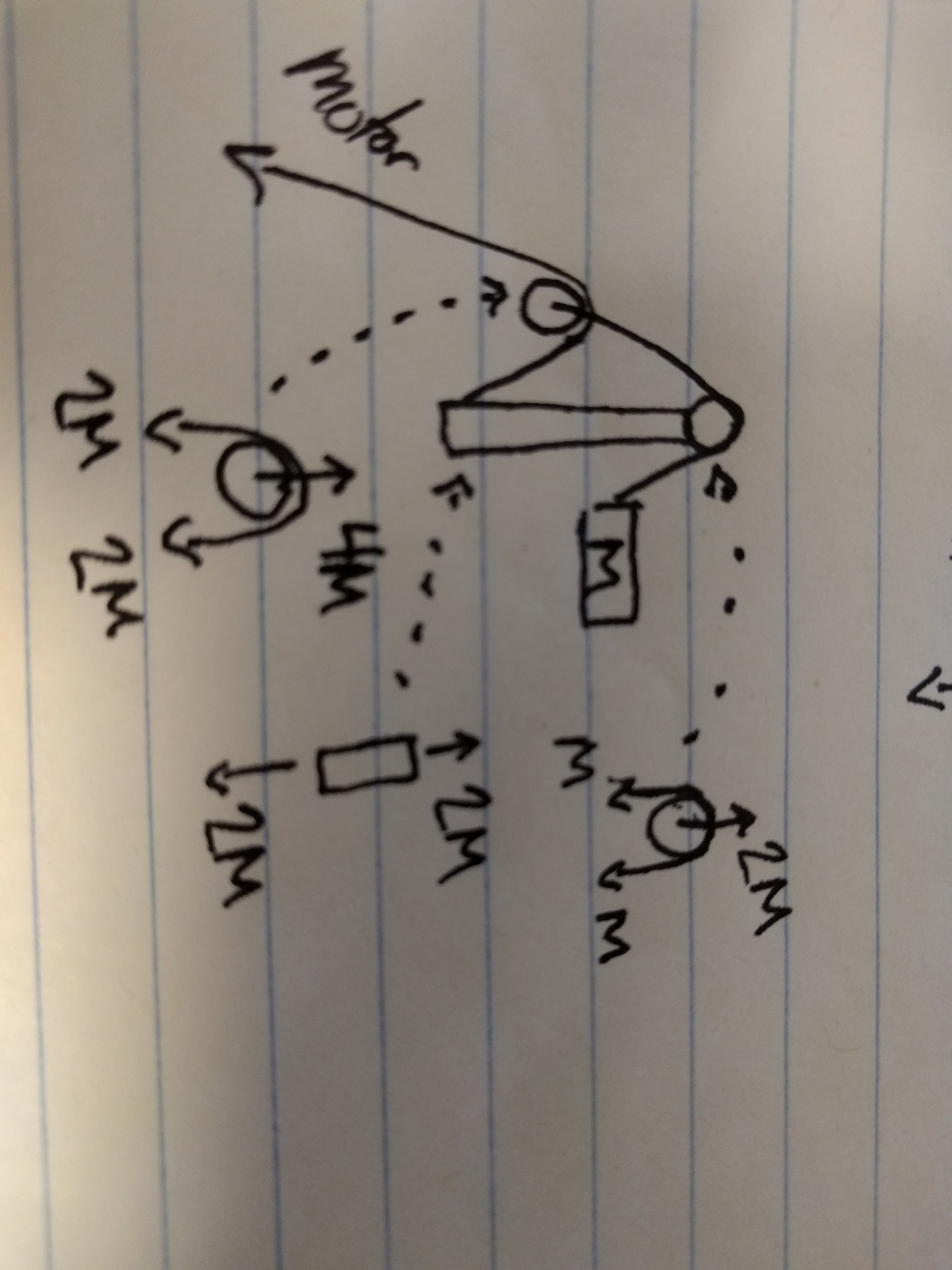

Maybe drawing a free body diagram will help get you started. Depending on the design, some multi stage lifts will have varying loads, and some will have a constant load.
In the varying load example, you will be lifting one stage from lowest to highest, then lifting the next stage and the first stage together from the second stages lowest to highest and so on.
In the constant load example, you will lift all stages at the same time from lowest point to highest point. The free body diagram may look like this (sorry for the bad picture):
You will have to use a 3:1 ratio to account for the cascading effect I believe.
Maybe I’m thinking about this wrong, but wouldn’t a 3-stage cascading elevator be an effective 4:1 reduction? The first cascade doubles the force, then the second doubles that doubled force (i.e. quadruples the force)
