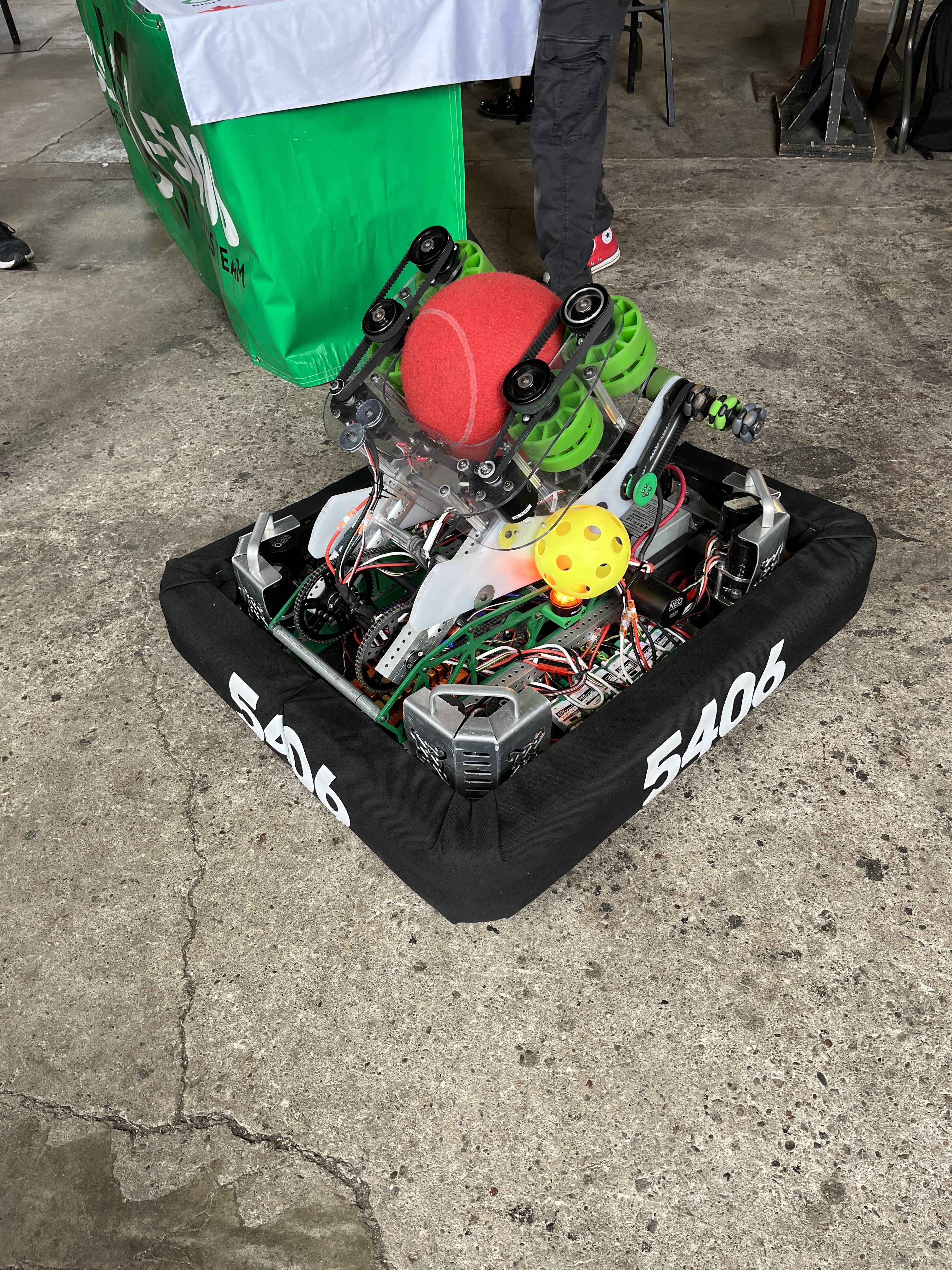

Q-Bert (Cube-Bert) is an 80 lb. cube runner that can score every level on the grid. We made the dimensions 28” x 24” (without bumpers), the same as our in-season robot, Edwin so that we could reuse old bumpers. We used this as an opportunity to learn new skills and test new ideas. This robot was made in 4 weeks (or 8 meetings of about 4 hours) using inspiration from team 1923 The Midnight Inventors.
Drivetrain:

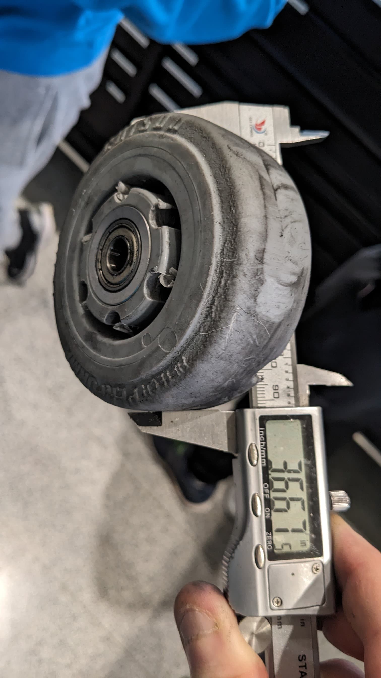

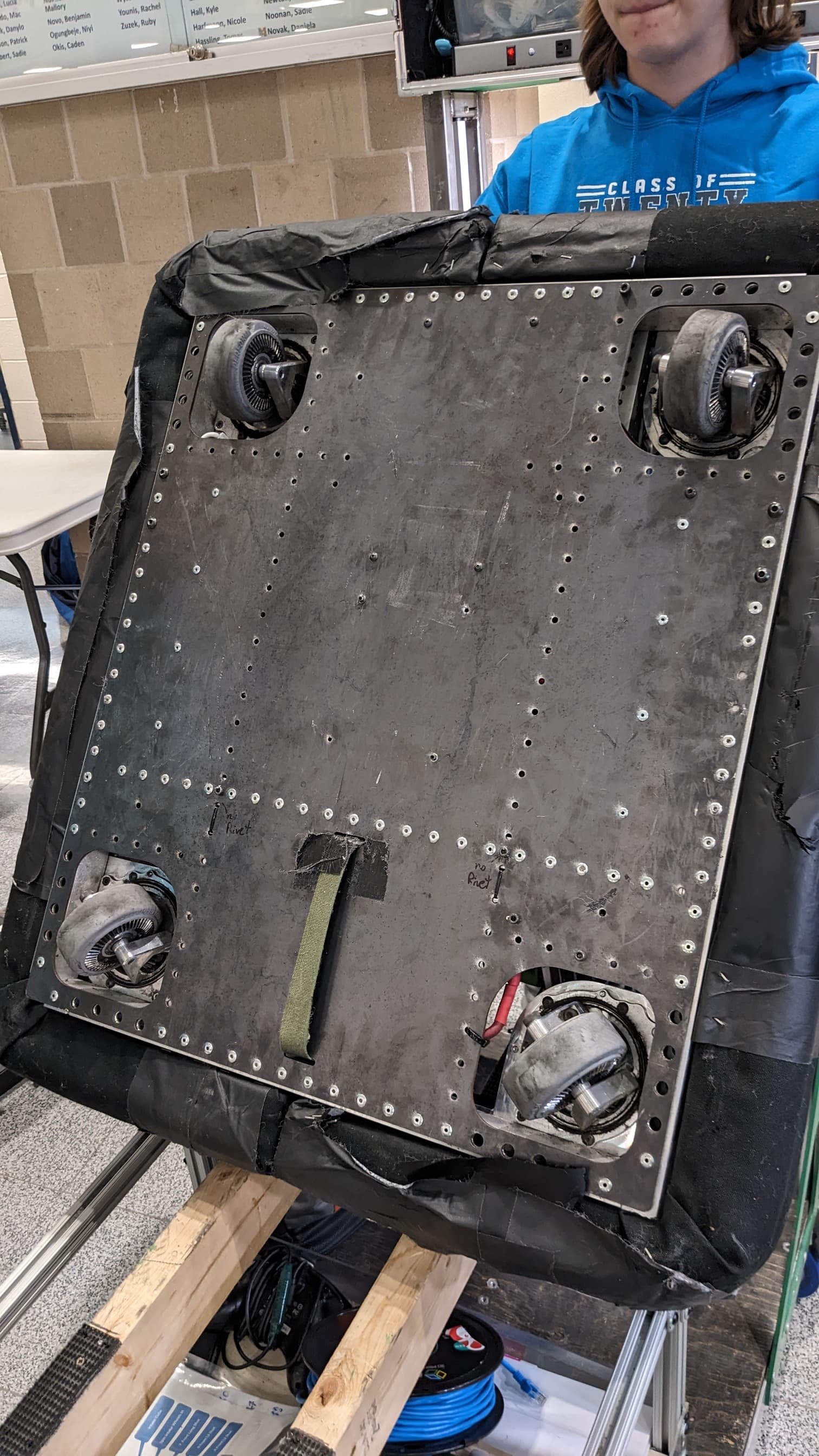

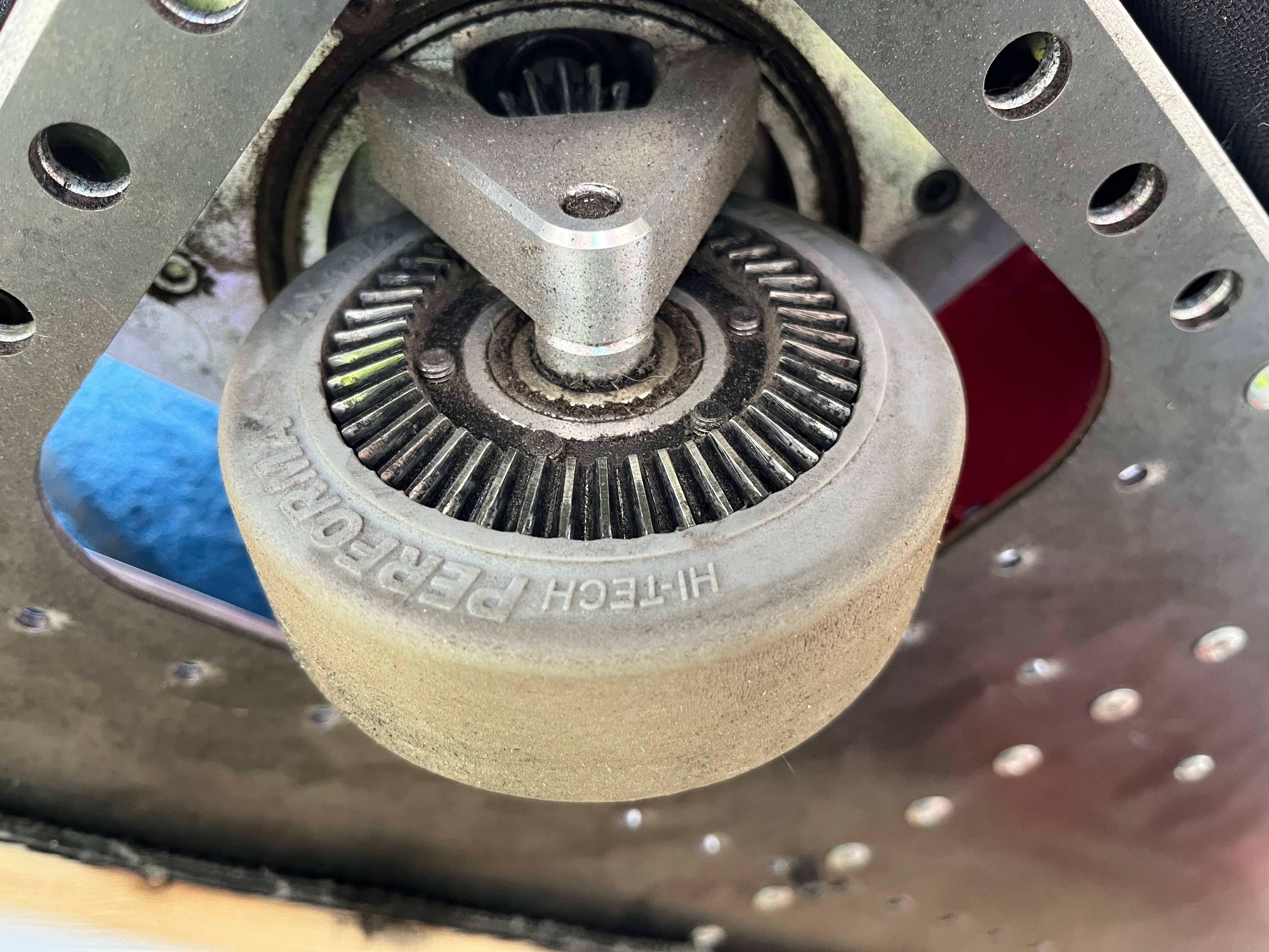

For our drivetrain, we decided to do something new - summer 2022 was our first time using swerve, and we started off with treaded wheels, and as we used swerve during the 2023 season, we noticed that tread wore away extremely fast which had major consequences with things like autos. This summer 2023, we decided to try out colson wheels on our SDS Mk3 swerve modules to see if they made any major differences - we noticed that even as a light-weight robot, we were still able to push around heavier weighted robots. Although we only played one competition, the wheels held up well compared to tread and we didn’t have to do any maintenance. Most of our findings do require more data and testing - this is just what we’ve noticed so far.
Intake:
Throughout the regular season, we witnessed ourselves and other robots struggle to pick up cubes, and we decided enough was enough. With some of our own testing and inspiration from 1923, we noticed that having a top horizontal roller as well as two sets of vertical rollers would get us closer to “touch-it, own-it” performance (which is one of our build philosophies even if we don’t always achieve it). The intake was designed to double as a shooter that could shoot cubes forwards and backwards, making everything far more seamless and efficient.
We also decided to try out different materials and ways to cut them because we have a habit of breaking intake plates. We normally laser cut all of our plastics, but for the first time we decided to try CNC routering Lexan to see if that would help prevent cracks. Unfortunately the lexan still ended up cracking once during competition (fortunately we caught it during pit checks). We liked that the routered parts came out cleaner, with less burrs though.
The long arms for the horizontal roller were made from laser cut HDPE. This material is extremely crack-resistant and did the job well, but it’s soft and weak compared to Lexan. One plate got bent pretty early in competition (see photo below) and while it didn’t fail, it changed the roller geometry a little.
Pivot:
This is by far Q-Bert’s simplest subsystem mechanically, consisting of 2 steel plates, a couple of hex shafts for supports, and two chains tensioned with turnbuckles. This was the first time we tried a Rev Max Planetary gearbox, and the female output made it really easy to mount to the wrist drive shaft. Originally we had a really rough and slammy intake, but thanks to a simple trapezoidal motion and profiled PID controller, the pivot is now a lot smoother.
One clever part of this pivot is that the long plates for the horizontal roller have built-in cams. When the arm rotates downwards, the cams push against a hard stop, causing the horizontal roller to lower into position for intaking. When the arm rotates away from the hard stop, the horizontal roller is pulled away from the vertical rollers by some latex rubber tubing. This moves the horizontal roller clear of the cube for shooting. Other teams with similar intakes used an air cylinder for this job, but our cams allowed us to do all the movements with one motor, and no pneumatic system.

Today we took Q-Bert to a demo on a cracked up concrete floor.
The colson wheels held up perfectly (other than a bit of dirt) after about 3-5 hours of straight demoing

At the end of STEMley, our Colson wheels had lost about 3/8" of diameter, enough to start affecting our autos. That means they’ve lasted 3 events, and one day-long demo. I think they’ve earned their retirement!

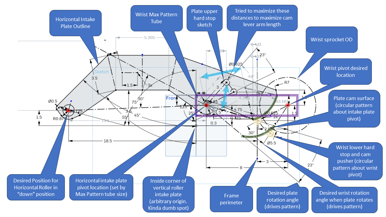

Did you design the cam in CAD? If so, what kind of sketches with what kind of constraints allowed you to simulate the cam motion and positioning?
We did! We’ll post some sketches once our Sunday event finishes today.
Sorry for the delayed response. You can find the original OnShape file for the Q-Bert’s cam-action “horizontal intake roller plate” here.
The driving sketch is a little complicated, and it was iterated over several weeks, with several designers so it’s a bit of a mess. To help make it less confusing, I’ve made an annotated version below:
The basic approach was this:
  • We drew how we wanted the plate to look in the “down / deployed” location.
  • We also drew the important details of the fixed superstructure in construction lines (the wrist pivot (red), the downward wrist hard stop (yellow), the frame perimeter, etc)
  • We decided how much we wanted the intake plate to rotate (about 23 degrees) and when that should happen (in the last 30 degrees of wrist travel).
  • We then patterned the hard stop by 30 degrees about the wrist pivot.
  • We then drew an arc (green) that was tangent to the hard stop and had a center above and to the right of the plate pivot which will form the cam surface (think of it as one tooth of a huge gear. Since a normal force on an arc points through it’s center, we wanted to maximize the distance between the center of this arc and the plate pivot point (light blue arrows) to give the cam the most lever arm length to work with
  • We then circular patterned the cam surface arc by 23 degrees, and made it tangent to the patterned hard stop, which provided most of the constraints needed to fully define the arc. That now shows the position of the cam right when it first contacts the hard stop.
  • We fiddled and tweaked with all of the geometry to make sure there was no interference with the other intake plates, the wrist pivot or the bumpers.
There might be a faster way to have done all this, but it worked. Does that answer your question?
Yes! Thanks for being willing to share. The key is now you modeled two positions of the hard stop and cam plate surface – each moving in a circular pattern around their respective pivot points. Brilliant.
