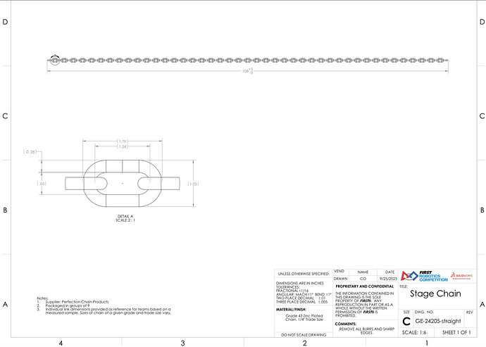

from the official game drawings (page 83) (also need the carabiners and mounting eyes, page 86)

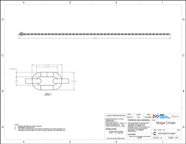

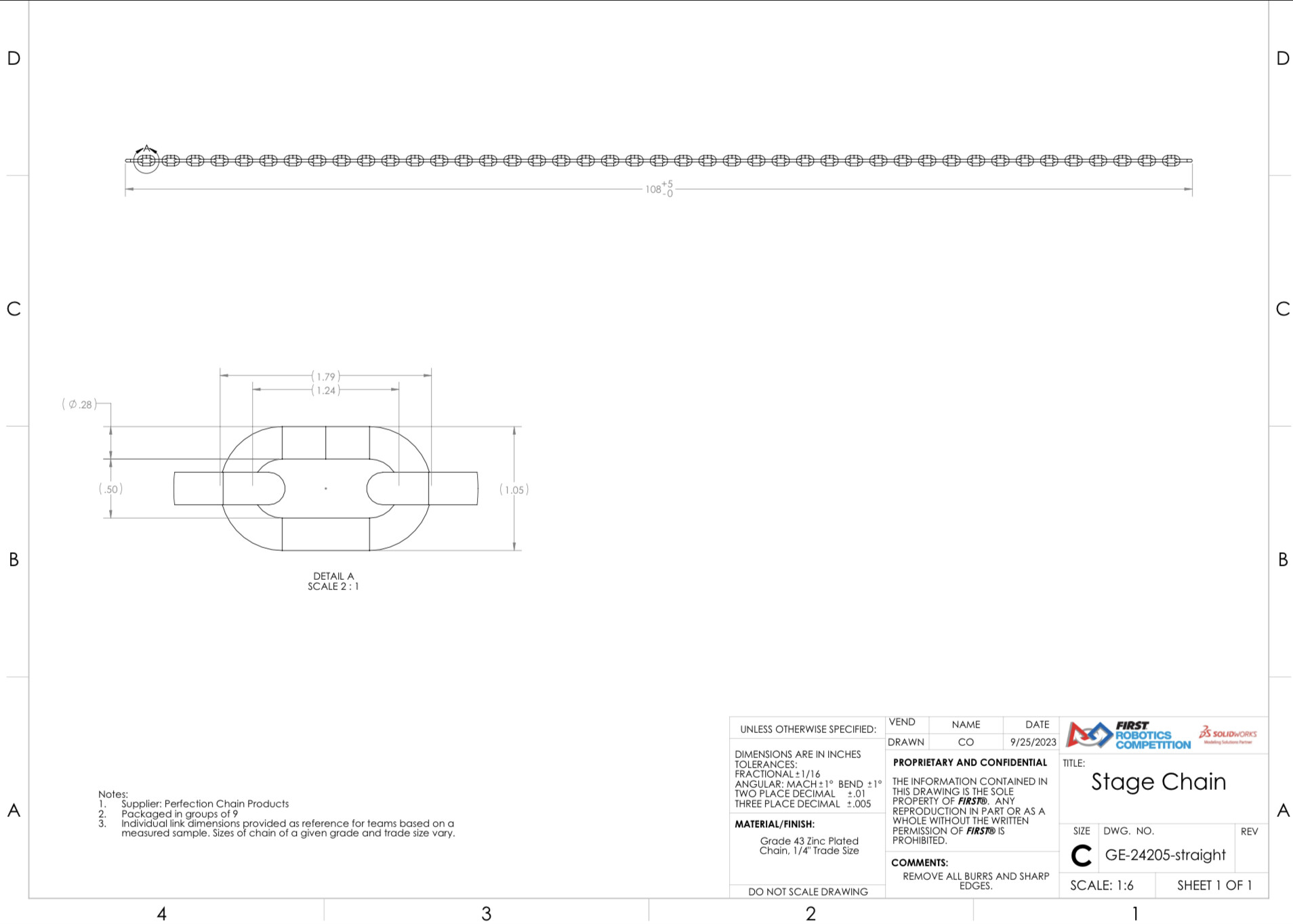

It isn’t in the manual, but it is given in the official game drawings. On page 93 of the full package, we get this:
So the length of the chain is 108 inches.
IIRC, there is a carabiner on the end, so closer to 110" I think when installed. The catenary math says ~110.1 or so.

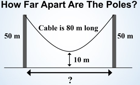

This reminds me of a classic interview question reportedly used by Amazon…
Answer… No
