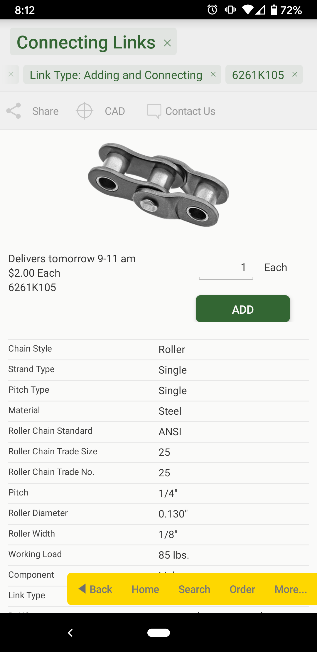

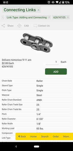

To be fair, I should add that half links should be avoided, if only because it’s one more small finicky item that you have to keep in stock and know how to install. Plus, chains that are too tight or too loose decrease your efficiency. Properly calculating your c-c distances is definitely the right way to do it. But when it comes down to it, chain lengths are fairly forgiving.
Use one-and-a-half links (McMaster calls them add-and-connect links) rather than half links, they’re stronger.
