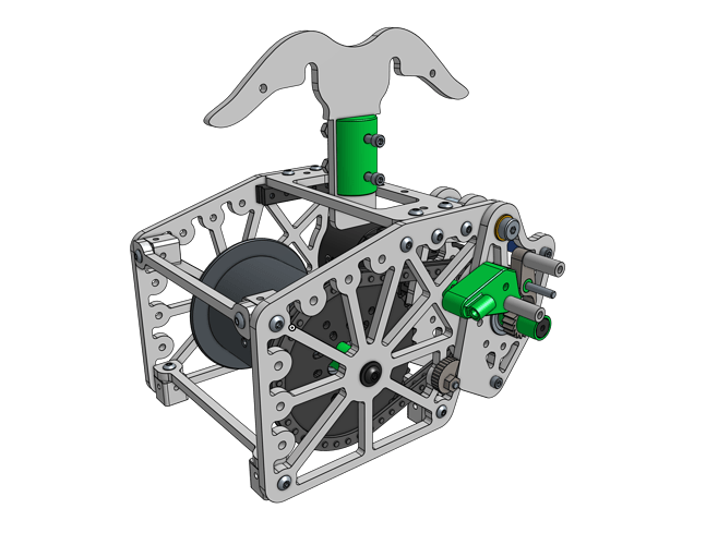

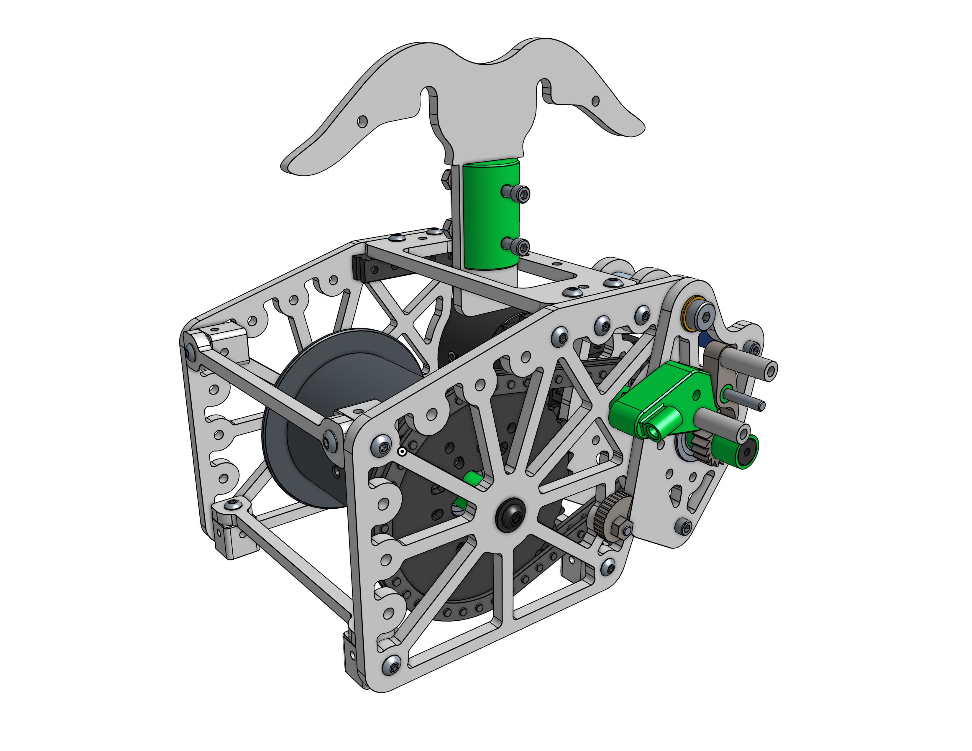

Here’s our working prototype model. It’s not built totally in accordance with the model, but we’ll work to keep it as accurate as possible.
I envision our final iteration being much more compact and lightened 1/4" aluminum. It’s quicker & cheaper for us to route polycarbonate.

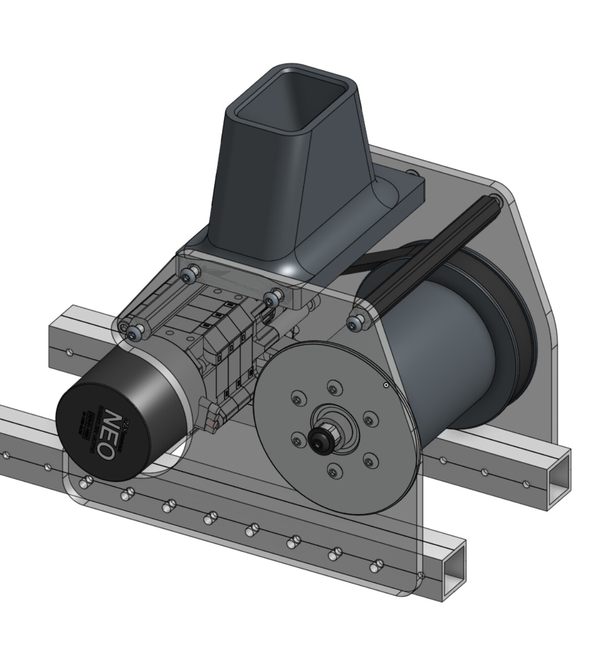

We’ve been testing and tweaking various aspects of our prototype (model screenshot in the first post). We are moving on from HTD timing belt, discussed briefly here in 4481’s wonderful OA thread. We stopped the belt from slipping (bonus shop dog in the background) on the small pulley by adding a crude tensioner, but felt more comfortable throwing #35 at it, and calling it a day.
The new model uses #35 chain on 18x36 sprockets in addition to a yet undetermined MP reduction. We’ve added a WCP ratchet and pawl to allow us to shoot for an aggressive climbing speed without worry about backdriving post match.

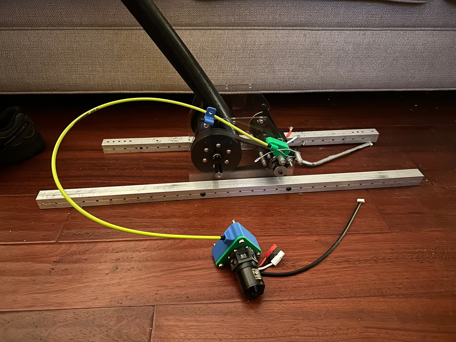

The pawl is actuated by torsion springs and a bike brake cable. We’ve been playing with a NEO550 based system to actuate it.
This is the only shot we have of the whole system in its current state.

We are bolting an aluminum hook to the end of the tube. The current plan is shown below, (carbon tube not shown). The green parts are printed spacers to sandwich the aluminum hook inside the carbon tube.
We will extend the climber, drive into the chain, and winch ourselves up.
