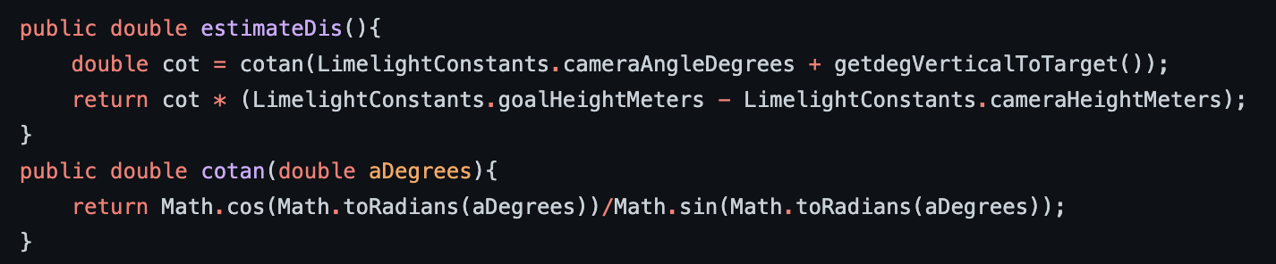

Thank you. One thing that I’m not sure how to adjust for is if we need to quickly shoot a shot by just going up against the bottom hub and launching up, at the angle I doubt the camera will be able to get a reading on the reflecting tape. Is there a way to account for this or will I just need to make an override button to set a RPM for that? Also for the equation, I don’t know how to get a2 and how would one implement this into a Java program?
I’m guessing unless you want to try and make moveable limelight, you would need an override button (you could also get fancy with it and do it with odometry).
As for the implementation, here’s what we did:
(the cotan function should probably be in math utils if you have one though)
Actually, it’s A1 that you need to know, A2 comes from the camera.
The way to calculate A1 is to put the camera at a known distance and run the math ‘backwards’ to solve for A1, presuming you can determine H1 accurately.
Or, you can measure it.
Well that just takes the fun out of it :wink:
Okay thanks. So, would the limelightconstants be a file you made similar to robotmap or constants? and if so, can i use my current constants file to hold all of those values? Also the get degree to vertical function would equal a2. BlueEpiphone mentioned that the a2 comes from the camera, so what does the function work?

Else, A2 is just the Y value that the LL or other processor will report over NetworkTables.

Yep, the limelight constants can be stored in whatever file you want.
Here is the open-source limelight library we use for all the measurements: Library (Limelight.java)
Example usage: Robot example
Btw:
a2 is the value returned by getdegVerticalToTarget()
a1 is cameraAngleDegrees
h1 is camerHeightMeters
h2 is goalHeightMeters
I would recommend a separate button for shooting against the fender. You could check if the limelight had a valid target during distance calculation and use a minimum, fender-distance shot if not, but this would mean anytime you fail to acquire the target you will default to a straight-up fender shot.
