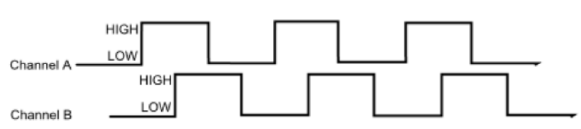

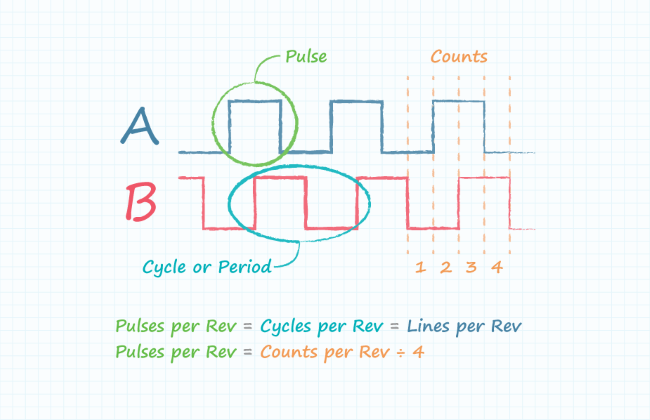

As I understand it, this encoder is 1024 cycles per revolution, and one cycle has four counts (edges).
My confusion is whether or not, in this context, the pulses-per-revolution is the same as the counts-per-revolution. If a pulse is the high signal on one channel, would that mean one revolution be 2048 pulses per revolution (1024 pulses X2 channels)?
Assuming it’s being read by a SRX or a Spark MAX, it’ll be 4096. If you plugged it into the Rio’s DIO, it’ll be 4096 assuming you didn’t explicitly select 1x or 2x mode on the encoder class.
PPR is measured single-channel, but CPR is the max amount of information you can extract from the waveform (4x PPR)

Characterization takes the number of edges, so, the larger one.
Right, and even solomondg’s reply is confusing to me because I read CPR as cycles-per-rotation, but this must mean counts-per-rotation.
Why does the documentation say to enter pulses-per-revolution, which I assume is what solomondg means by PPR? A single channel’s PPR is 1024, see the confusion. What the tool is actually asking for is counts (or edges) per revolution, at least in this case.
Anyway, 4096 it is!
Because I haven’t gotten around to changing it to say “edges” yet.

FRC-Characterization now unambiguously uses “edges” rather than “pulses.”
