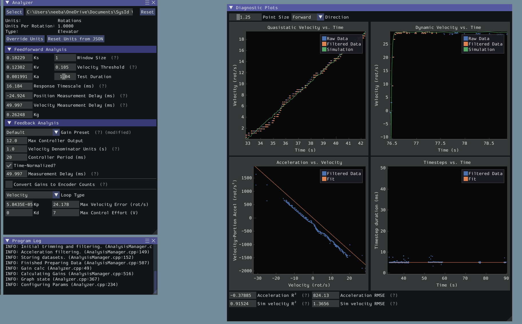

So I characterized an elevator single motor but two chains using sysId.
I know that kG / kA should give 9.8 m/s^2 but for some reason I’m getting double that value.
Would using a single motor but with two chains cause the kA value to halve and the therefore kG/kA to double.

Now a note on this. I collected the data in straight up motor rotations. No gearing or drumRadius was used in sysId. (I was still learning about its features at the time).
Though not factored into the sysid setup the gearing for the motor was 16 : 1. Each sprocket had a diameter of 1.76 inches
And the diagnostics image
Your data look fine, and you’re probably seeing that your system loses about half of its available torque to frictional losses in the transmission.

I also tried recreating your conversion of listed kA of .001991 V/(motor rotation/s^2) to V/(m/s^2) and got kA = .001991 / (1.76*.0254*pi/16) = .2268 V/(m/s^2), which gives kG/kA = 1.15, which is far off from 2x 9.81. Could you elaborate?

Actually now that I think some more about it, wouldn’t kG/kA be considered effective gravity. The gravity of the system given external frictional forces. This would make sense (barring whatever bad math I was doing last week) as to why it is 1.15 m/s^2
When torque efficiency of the transmission decreases, kG gets smaller but kA gets bigger. So, their ratio shrinks by the square of the efficiency. Remember that the motor and the gravity loading are on opposite ends of the transmission.
If Rafi’s calculation is correct, we have that the efficiency is about sqrt(1.15/9.8), or approximately 34%. That’s a very lossy transmission.

I tried manually estimating kA and just from eyeballing it looks like it could be as high as .0036 in native units or .411 in SI units, yielding an effective gravity of .639 m/s^2 (which is even worse than before).
I’m not suggesting that this is worth doing, but I would be interested in seeing if repeat trials or alternate procedures could yield values that make more sense. Realistically, I don’t think any of this is particularly impactful to on-field performance.
To get a more-accurate kA estimate, you can trim your step voltage test data to exclude the long steady-state “tail”, which contains redundant information and dilutes the fit.
