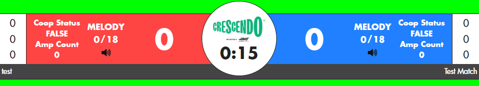

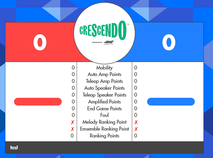

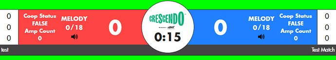

My 2024_Preseason branch fork has accommodations for this years game. I usually try to get something put together for our week zero and preseason. GitHub - cpapplefamily/cheesy-arena at 2024_Preseason
I also have some raspberry Pi <> Arduino code I been working on to score the amp the 2024-refactor and 2024_refactor_JSON branch is the start of it. I had a bunch of issues this weekend with the JSON object getting corrupt this weekend at the NMRC week zero so we ended up manually scoring. I used this system in the past with simple [byte] messages over USB serial. I now needed a bit more information so I was trying to use JSON and UART serial for a longer distance from my alliance station network box and the amp. GitHub - cpapplefamily/CheesyColorSensor at 2024-Refactor
My plan the next few weeks will be to try and get the data I Need using just short [byte] messages.
Yes that was ME
Here are some screen shots
This is awesome, we will definitely take a look at using this next year. Thank you for sharing this!
This is really cool and looks really close to hows Chezy Arenas’s display might look but im going to offer some minor suggestions involved the score breakdown. I would just combine all Amp points into one category as well as all speaker and amplified points. In addition I would just rename endgame points as stage points just to make it clear where they came from

I’m totally aware. When I was roughing it out I simply displayed it ALL for debug purposes. Also the “Official” displays where not released when I was at that stage of the project.
The past few years I have been using the previous years Cheesy Arena and adding the scoring objects for this season on top of what’s there. I have never touched the TBA stuff so synchronization would be limited. Final scores might post but that about all. Its been more a tool to put on a good show at the event. When the new release for CA is finally available I have modified it to accept 4-8 team double eliminations along with a few other modification I like to have.

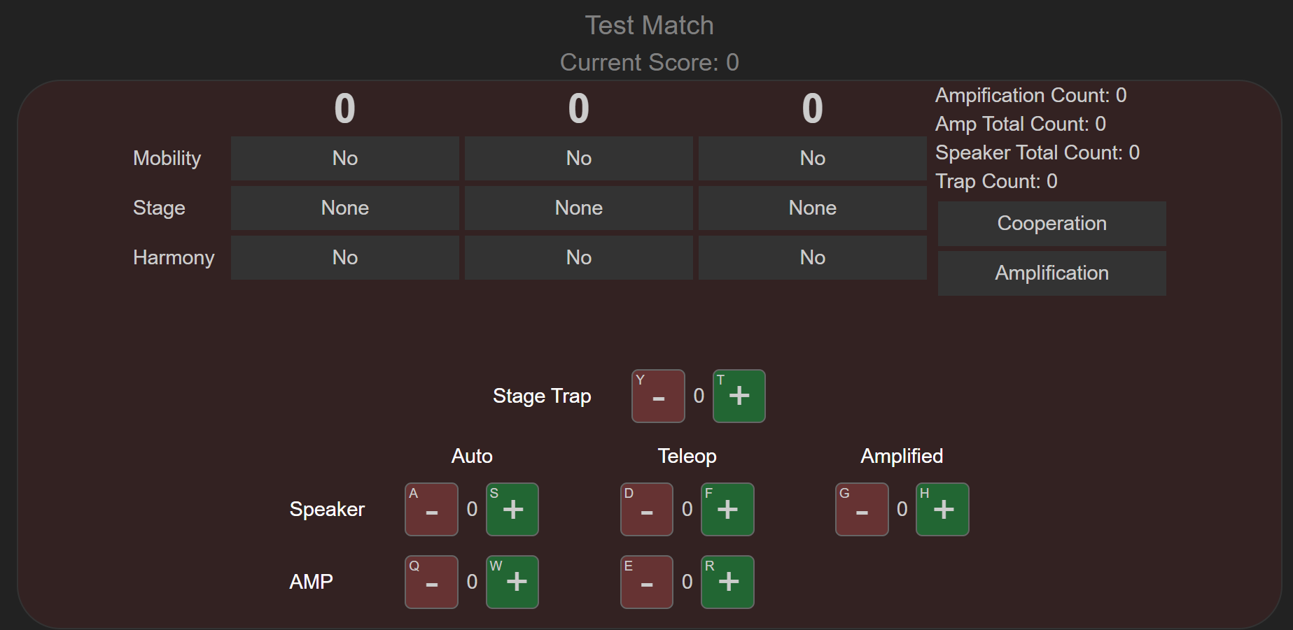

Girls of Steel/Steel City Robotics Alliance used Cheesy Arena Lite for our Week 0. We had a mentor on another team that built a scoring app to help a red and blue scorer track scores, then we just put those in CAL for final scores. It’s not 100% accurate but gave everyone a good rough idea of what was happening.
(We tried to set up electronics for the amp/speaker/subwoofer but just didn’t get it finished in time, mostly because my FTC season’s last week of competitions overlaps with our FRC season’s first week of competitions.)
The electronics infrastructure we’re in the process of setting up for Steel City Robotics Alliance is available at GitHub - fixermark/frc-2024-field-server: Python server and Arduino clients for field element control, FRC 2024 Crescendo.. It doesn’t integrate to Cheesy Arena at all; you’d run it on a separate machine and hit spacebar at the same time you start a match to sync the clocks (and it’s not quite complete—a lot of it is tested in simulation but not yet on live Arduinos).
But more functional is the quick-and-dirty scoring calculators we put together. FRC 2024 scoring. “full” is for a human scorekeeper watching the speaker and “amp” is for a human scorekeeper watching the amp. I haven’t formally published the source code for these yet (because they were that quick and dirty :wink: ), but they’re both single-page standalone HTML with all their code in the page; if you want to copy and tweak them, you may consider this post my formal release on the source code under the ISC license (copyright 2024 Mark T. Tomczak). I’ll get a more formal ISC release into the code (and the code up on GitHub) when time permits.
