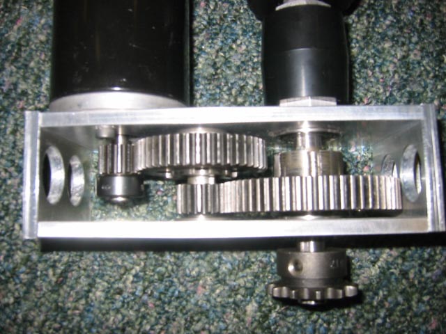

Simple Gearbox for one chip
http://www.valleytech.k12.ma.us/robotics/images/2002Pictures/2002%20Gears1.jpg
Simple Gearbox for two chips
http://www.valleytech.k12.ma.us/robotics/images/2004Pictures/2004_24wheels.JPG
or
http://www.valleytech.k12.ma.us/robotics/images/2004Pictures/2004_29electronics2.JPG
better picture
http://www.valleytech.k12.ma.us/robotics/images/2004Pictures/2004chipgear2.JPG
We did not have a drive train problem all year except for breaking 2 belts.
I see a bit of a problem here (regarding pictures 2 through 4), and I believe that this came up earlier (in this thread). You’ll notice that the CIMs those pictures have (instead of an 8 mm keyed shaft) a sort of small gear built into the shaft (if memory serves, it’s a 25° pressure angle piece–very non-standard). This version of the motor (the Atwood AP801-001 motor by CIM) was supplied in 2002 only. It was specifically legal in 2003, but not supplied in the kit (the FIRST version of the CIM motor, FR801-001 was introduced that year). For 2004, the FIRST-CIM was supplied, and the Atwood-CIM is no longer legal, per <R09> and <R70>. Electrically, they are very similar (but not quite identical, if the specs are to be believed–I’m looking at copies of both), but mechanically, they are different, due to the shaft configuration.
Now, there are pictures of a what appear to be a different version of the gearbox on their website–here, here, and here–was this modified version intended to use the correct CIMs? Or is this something else entirely? Edit: Looking at other photos, those are something else entirely–they’re for the winch.]

yes its legal. we did nothing wrong. the good picture was taken with other ones while the new ones where being cut. we did nothing wrong. That gearbox is what we used this year and what we will be using in the offseason comp.
Please note that you’re not being accused of wrongdoing–like I said, I’m taking you at your word that you replaced the outdated Atwood Mobile AP801-001 motors shown in those photos with FIRST-legal FR801-001 motors, and made whatever necessary and legal modifications that were required to make it work.

If you are using large wheels, or don’t have room for a large final reduction and would like to run the drills in low with the Chias (or just the Chias by themselves), I would recommend the team 716 2003 single speed gearbox (found in the whitepapers) Team 980 and 696 used it this year with great success. It is a little more complicated to build than the pics I linked to above but it is very reliable, small, efficient and lighter. It has a nice slow output speed of 460 rpm.
Attatched is a pic of ours.
