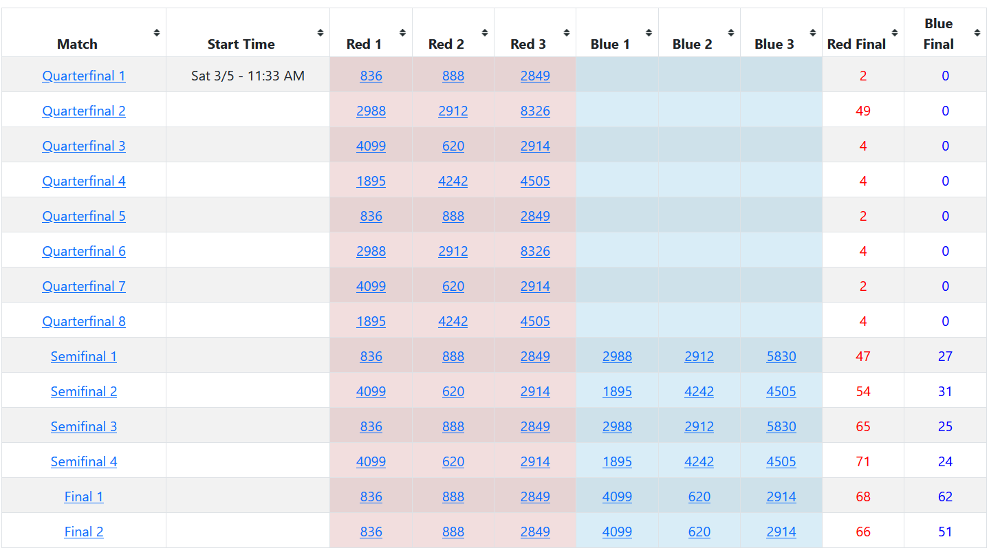

The playoff results still seem pretty messed up on FRC Events:
qf 1 still appears to be waiting to be played, there are a bunch of blue teams missing, and somehow there is a reasonable score for qf 2.
Yep.
Hopefully this data will be correct and frozen on Monday, 3/28 as promised.
