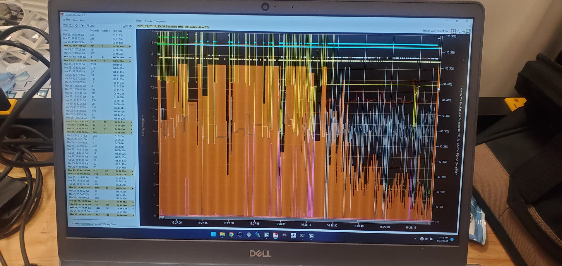

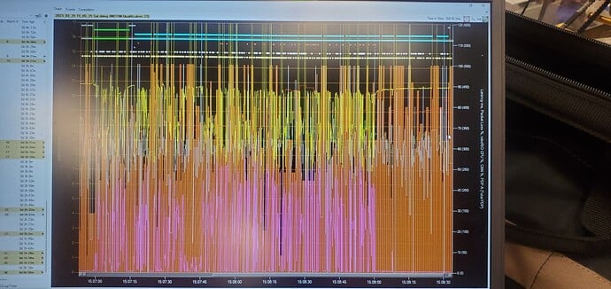

CHS Timonium Event Packet Loss
Throughout our whole event at Timonium, we’ve seen incredibly high packet loss when connected to FMS. After talking with many other teams and the FTAs, it seems almost everyone is encountering the issue. This is very frustrating as it is costing many teams ranking points. If you’re suffering the same issue, can you reply with a picture of your log?

Was this graph on the field in a match (I don’t see the auto/teleop colored bars at the top), or in your pit? If in the pit, were you connected via ethernet or USB (I presume not wifi becasue event rules prohibit it)?
If every team is affected and it’s only when connected to the field over wifi, then it’s likely from a hostile wifi environment in the venue and the FTA should be working with their support contact and event management to coordinate a less congested channel.
If not every team is affected, or it happens when tethered (ethernet or usb) in the pits, then you should be working with the CSA to troubleshoot. Most likely culprits are old software (rio image, DS version, etc), high CPU/RAM utilization on Rio or DS, other software running in the background on DS (i.e. windows updates), or radio placement.
This was in a qualification match. It’s affected every robot since Quals 1.
Yeah… This was definitely a widespread and systemic issue. We are talking at least a dozen teams having this issue. While we (836) were part of the alliance that ultimately won the event, it certainly left a bad taste in our mouthes. The entire event would have gone very differently if the fates of each team were decided by robot/drive team skills rather than the whims of packet loss. Here’s a sample of the log files that were shown to me. I don’t have an exact count but it seems like we had this issue in around half our qualification matches.

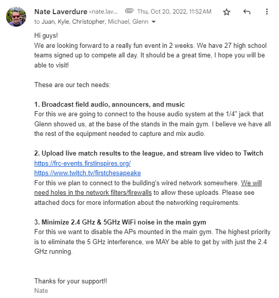

There’s absolutely nothing about it in the District Planning Guide or Appendix 1 - Venue Site Selection, only the requirement for 2 ethernet drops for the FMS and webcast.
FIRST Chesapeake distributes a document called “Robotics Competitions Venue Network Requirements” which sets the requirements for its event venues. Folks should ask FIRST Chesapeake for a copy. I’m unsure how much of the document content came from Manchester versus was created indigenously.
Here’s what our offseason event communicates to our stakeholders each year:
This is the only sections that deal with Wifi in the “Venue Network Requirements” document sent out to venue contacts:
Wireless Requirements [Channel Availability]
FRC equipment will create and utilize: (will not be provided by venue)
  • 1 Channel, 5 Ghz, 802.11n
    • 20Mhz channel width, Band 1 or 4
    • Channels 36, 40, 44, 48, 149, 153, 157, or 161
  • 1 Channel, 2.4 Ghz, 802.11b
    • Channels 1, 6, or 11
  • The venue should ensure that at least one of the channels listed above is clear for event use and report this channel to the contact details at the bottom of this document.

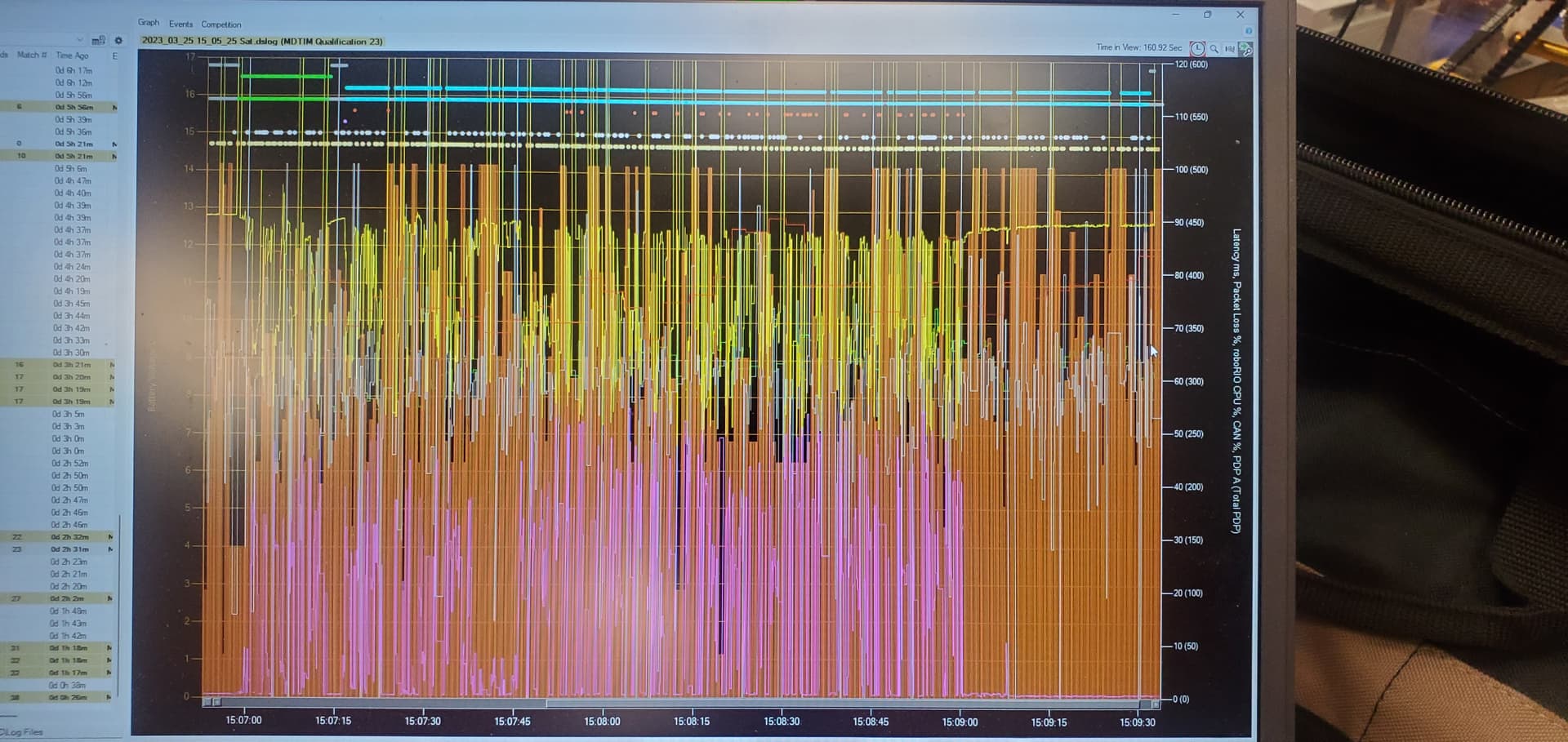

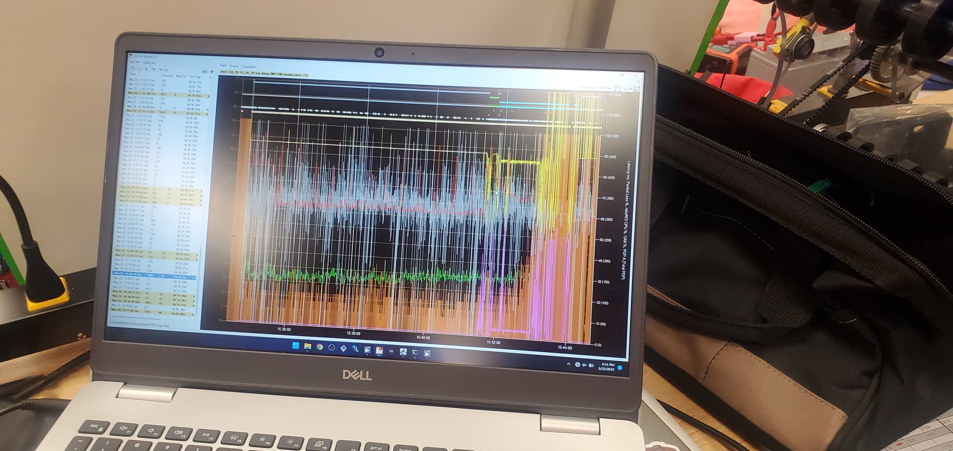

We did see the same, in the beginning we were told it had to be with our setup and it got to the point where we played with the Rio plugged into the radio directly, bypassing POE, and no vision or network switch, and a network cable I borrowed (and forgot to return -ed) from the spare parts station.
Some matches were better than others. For some it was terrible right up until auto started and then it was normal-ish. Sometimes it was throughout. We saw disconnects in DS, sluggish response on the robot, and auto routines not running.
The last bullet was in fact not the issue. The venue had internet available for FMS, and they could communicate out perfectly fine. The connection from FMS to the robots was terrible.
The issues we saw were nothing to do with team error. This culture of assuming that every issue comes down to a team problem isn’t helpful. This was a systemic issue throughout the competition affecting 30% or more of the teams and seemingly random intervals and severity.
