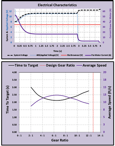

I’m not Sam, but 1293 ran six Mini CIMs at 7.31:1 on 6" wheels this year and loved it. Inspection weight was around 90-95 pounds if I remember, so we were probably around 120 fully loaded. We designed that around 15-foot sprints, which is shorter than your intended sprint.

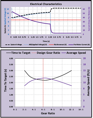

Using iLITE’s spreadsheet linked above, and assuming you’re around 143 pounds fully loaded (the most we see in FRC and probably not totally implausible with that many batteries on board), a 5.95:1 ratio (achievable using AM Toughbox parts in a 3CIM4U) yields a 2.5-second sprint to 26.25 feet (8 meters, roughly) at full tilt boogie and keeps the current draw below 40A per motor after the first second or so.
But then, a 12.75:1 ratio (the max reduction in a Toughbox Mini-derived setup) still keeps that sprint under 3 seconds and has a noticeably gentler curve on both per-motor current draw and total system voltage:
For something that’s going to run 45 minutes, I know which curves I like better.

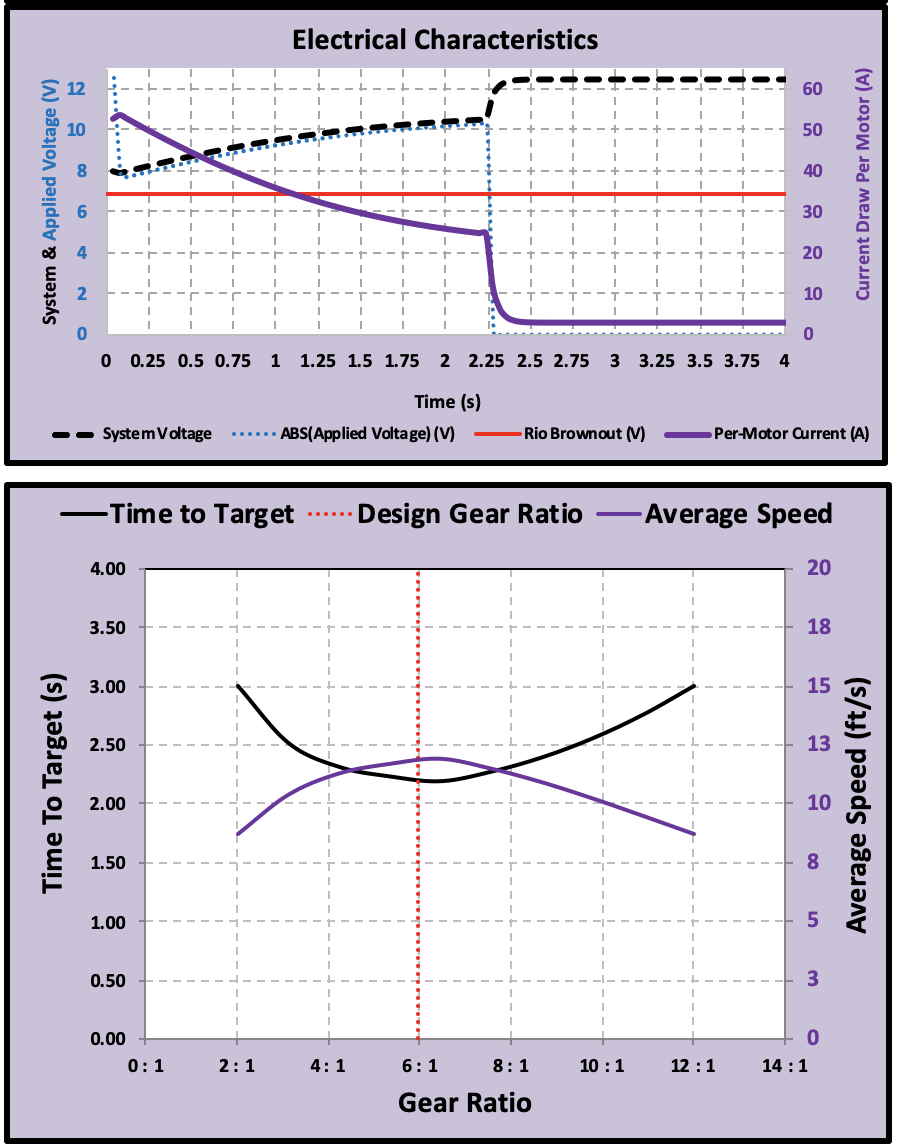

Plug that into the iLITE calculator, and a 7.7:1 ratio is as fast as will get you 8m in 3 seconds. Switch to 4" wheels, and the max ratio goes to 9.4:1 which should open up more COTS options. In either case, go with the highest gear reduction with an acceptable time to minimize current draw.
