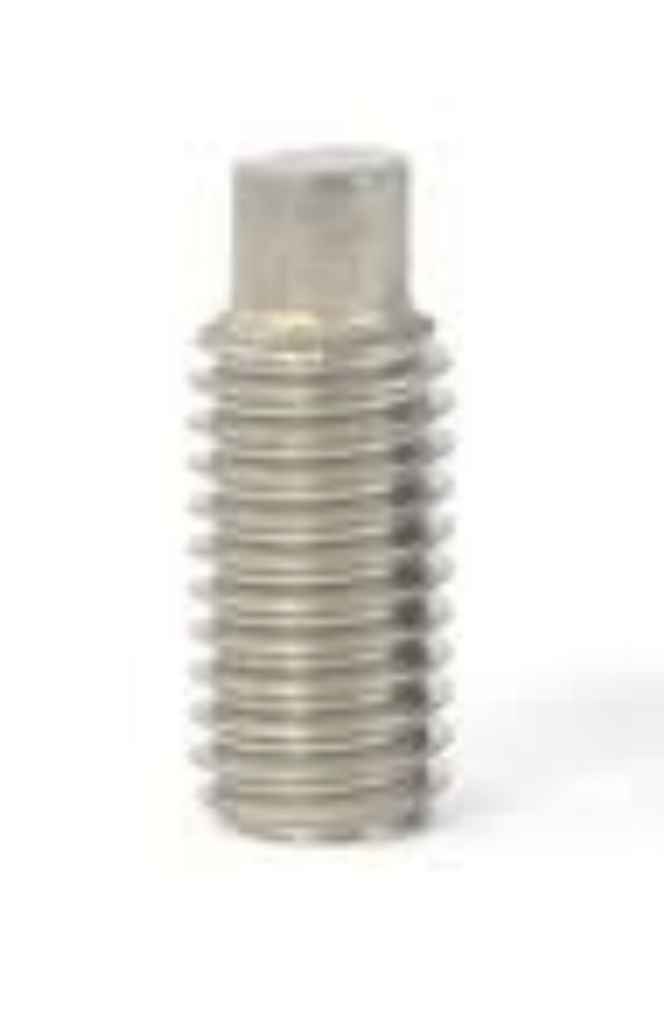

There’s something called a “dog point” setscrew. Get the appropriately sized one that fits into a 2mm keyway on the motor shaft, and completely forget about slippage.
Something like this could work: https://www.mcmaster.com/92905a051 (the keyway in the CIM shaft is actually 2mm).

We’re referencing these particular setscrews. They don’t rely on friction to keep a hold on shafts, as these physically engage into the keyway. 2-3 of these on a shaft is more than secure enough for a first stage shaft.
While setscrews may have been an issue for you in the past, that doesn’t mean they’re utter garbage. There’s plenty of good applications for setscrews, some of which that even transfer torque. I’ve had my fair share of mechanical design with high reliability systems, and I can’t tell you how many setscrews I’ve seen. It sounds to me like a poor design choice over a poor fastener design.
I personally try to stay away from setscrews, but they’re a tested mechanical solution and have their place. They’re extremely cheap and fit in small spaces.
I would never use a setscrew without some sort of positive locking mechanism (like the extended point, or a BIG flat on the shaft).
