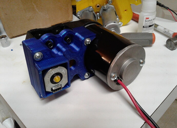

Faced with a similar problem, I ended up trying the CUI AMT-103 encoder. The plan was milling a pocket for it, on the clamping gearbox, opposite the motor, so the stack was motor-gearbox-encoder-gear. It all fit together, but it does mean milling out a distressing amount of webbing. You have to use the 103 or you mill out even MORE webbing. We never ended up battle testing it, so I can’t guarantee the weakened gearbox won’t crumple at a hard hit, but it’s another option if you have any milling capabilities.
We developed a way to use the CUI AMT-103 encoder we got from FIRSTChoice with the Vexpro clamping gearbox. If you have access to a 3d printer we would be willing to send you the files.
I believe team 558 developed a printed adaptor to be able to use a ctr mag encoder. Check their Facebook I saw a link to the cad
Amazing! I’ve sent you private message.
Thanks!
Replied.
If anyone else finds this useful just pm me.
