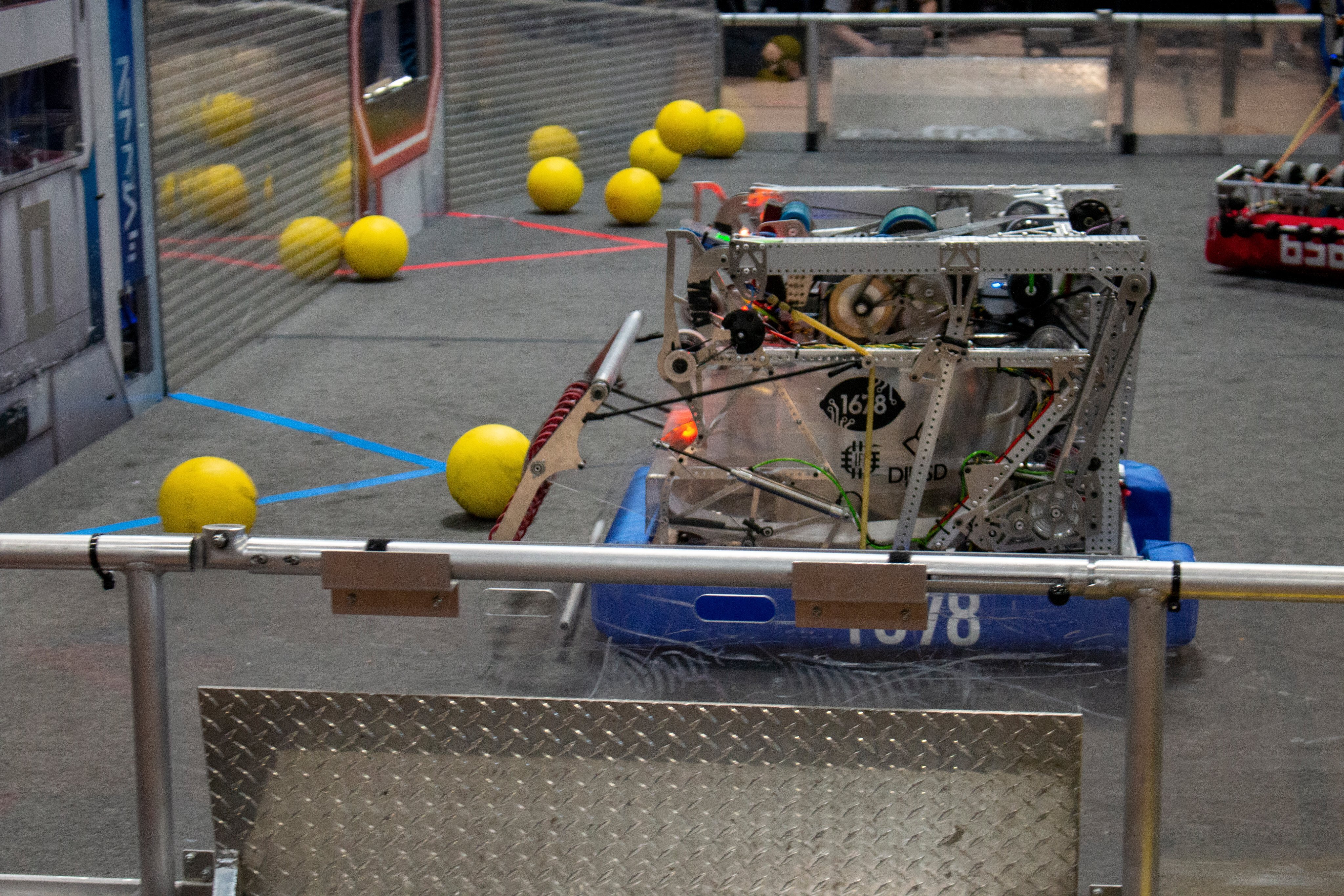

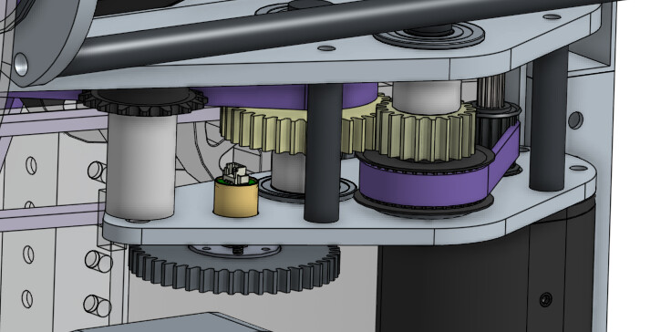

way cooler than our turret setup… we had some mad backlash problems and lost a few matches due to our hall effect magnet breaking off on some rivets once the turret broke itself in.
What was your range of motion? Does the ma3 cover the whole travel, or just a small expected starting zone?

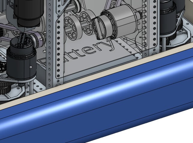

Also how did you get your battery in and out:
I imagine out the bottom, like all the cool kids.

Slid out the back, CAD is missing the cutout in the bumpers.

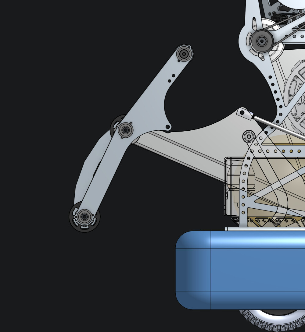

The intake actuation is really interesting to me. It looks like you’re only powering the intake deployment, but there’s nothing constraining the rotation of the roller plates (?). This seems like it would help if you drive into a wall or something, but how do you keep the rollers in a position where you can intake balls? Does it just tend towards the extended position by gravity or angular momentum of the rollers?

Iirc in real life there were some cords between the top of the intake arms and the superstructure. Similar to 973’s cords, I think?
Great question, here is an answer from our 10th grade design student Brendan, who designed the turret, but doesn’t have a CD account :slight_smile:
The range of motion on the turret is ~235 degrees, and the ma3 encoder tracks for the entire travel. We have the encoder set up to a 28.4:1 ratio relative to the motor, whereas the turret rotates on a 27.8:1 relative ratio to the motor, so for the full movement of the turret, the encoder shaft only rotates ~230 degrees.

Surgical tubing, ziptied through the two holes below the top roller.
