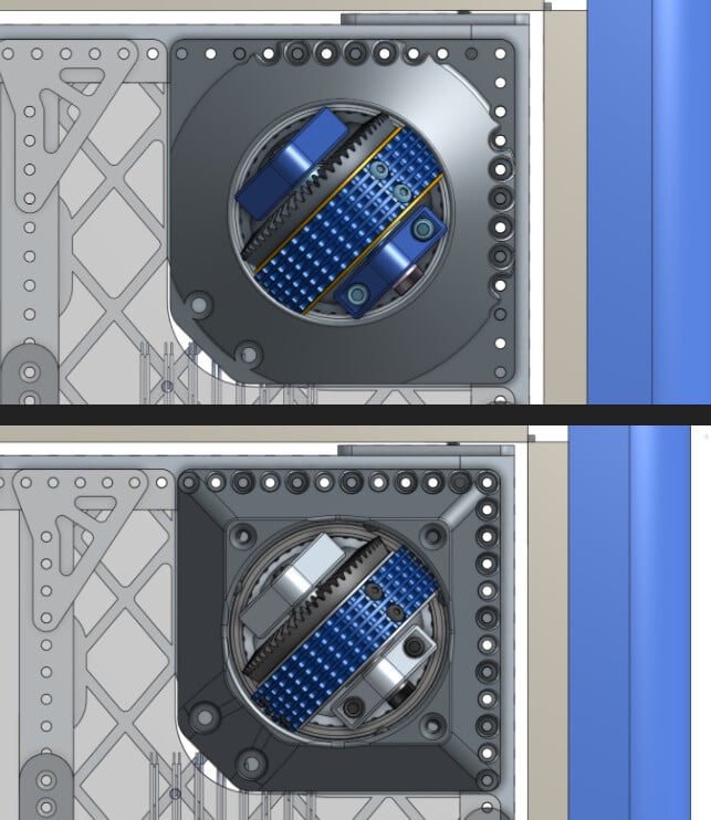

We printed all the wheel guards on our Markforged printers. We went through a couple iterations of the design on these after encountering some issues that we ended up fixing leading up to MTTD. The first image is our previous version (which we took to Chezy), second is the final (which we took to MadTown).
The first issue we found was that the hole clearance on the first iteration was too tight to remove the wheels, which made it tedious to replace tread when it wore out. There were also a few other issues we found when we started driving. The cone-shaped chamfer often broke when driving over the steel bars at the rendezvous point, and the bolts we used to mount these to the drivetrain rails were previously the same bolts that held the modules on, so when the guards would break it meant the modules weren’t strongly constrained to the rails.
For our final version, we increased the diameter of the hole for wheel removal, and we made some of the mounting holes large enough to fully clear a socket-head bolt. This made it so that we could have four bolts mounting the module directly to the frame and another four mounting the guard to the frame, so that if the guard broke it wouldn’t impact the integrity of the module. Finally, we changed the shape of the chamfer from a cone to the pyramid shape (below) so that we could add some 1/4"-20 flat-heads in to hold the layers together. All of these changes helped us get through MadTown with no broken wheel guards.

Thanks for sharing all of this really appreciate it. I really like your idea of putting bolt all the way through. Really makes it a lot stronger. Did you fell like it helped protect the swerve drive. Also where they 100% infill or what settings did you use for the markforge
Having the bolts all the way through definitely helped keep all of the layers together, preventing the modules from getting damaged. The previous versions left the modules more vulnerable since the bottom layers of them tended to rip off when we hit the rendezvous bars. As for what settings we used, we were able to get away with the default 37% infill and didn’t need to use reinforcement material or adjust any other markforged settings. Every guard was printed at either 0.1mm or 0.125mm layer height depending on when we needed them completed.
That is really good to know. We just got a markforge to trying to figure out what settings to use for parts that will see impacts. Thanks for sharing

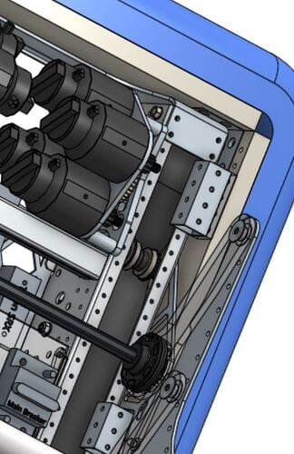

  3. Our design lead Zach Hoblit, talked a lot about wheel guards in a different response: Citrus Circuits 2020 and 2021 Code and CAD Release - #22 by zhoblit.
  4. Yep, we experienced issues where the flanges of the bearings would actually pop off during matches, and we ending up actually switching to using bushings for the 2020 robot. Those issues were the reasons we switched to having bearings on all sides yep!

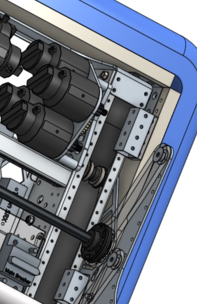

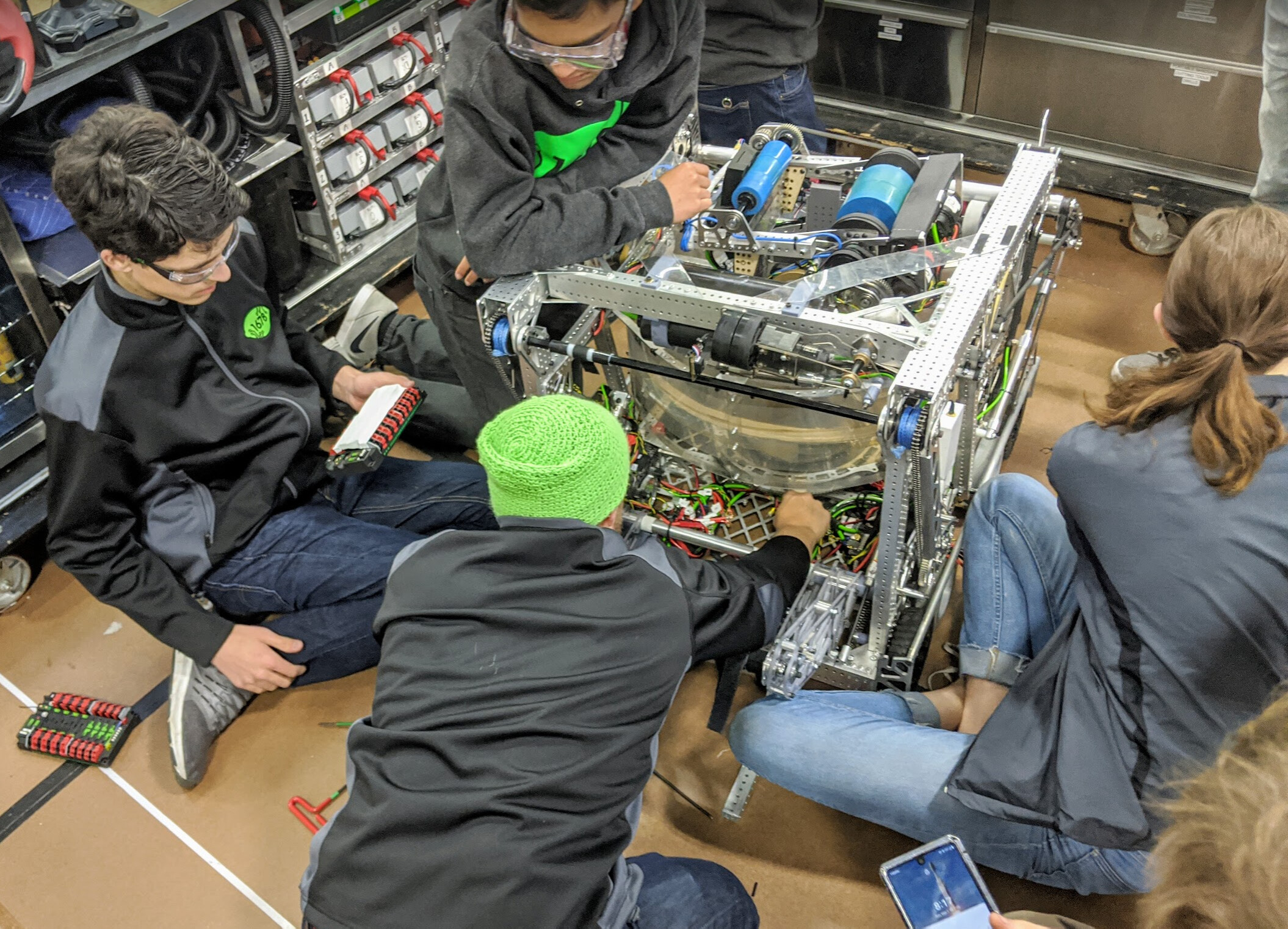

  5. For our team, we try to pick which bellypan to use based off of the robots packaging. In 2020 we tried the normal regular bellypan, but it led to major issues for wiring, so for the 2021 bot we reversed the bellypan to make it easier to access electronics. The main added difficulty with the reversed bellypan is making sure that there are cutouts and holes for routing wires, and making sure that the battery is secure.
like replacing a PDP wedged half under the indexer at LAN 2020. Big fun.
I physically winced being reminded of this moment haha. Big (not) fun!
