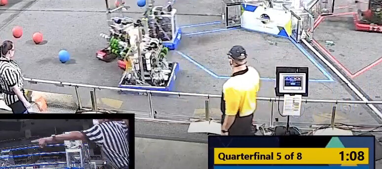

I can tell you double defense on a single robot has never been blockading. I don’t even have to look that far in history to tell you that is not the case. Just last year it happened a lot:
I do love the second photo because the head referee is looking directly at the double defense.
