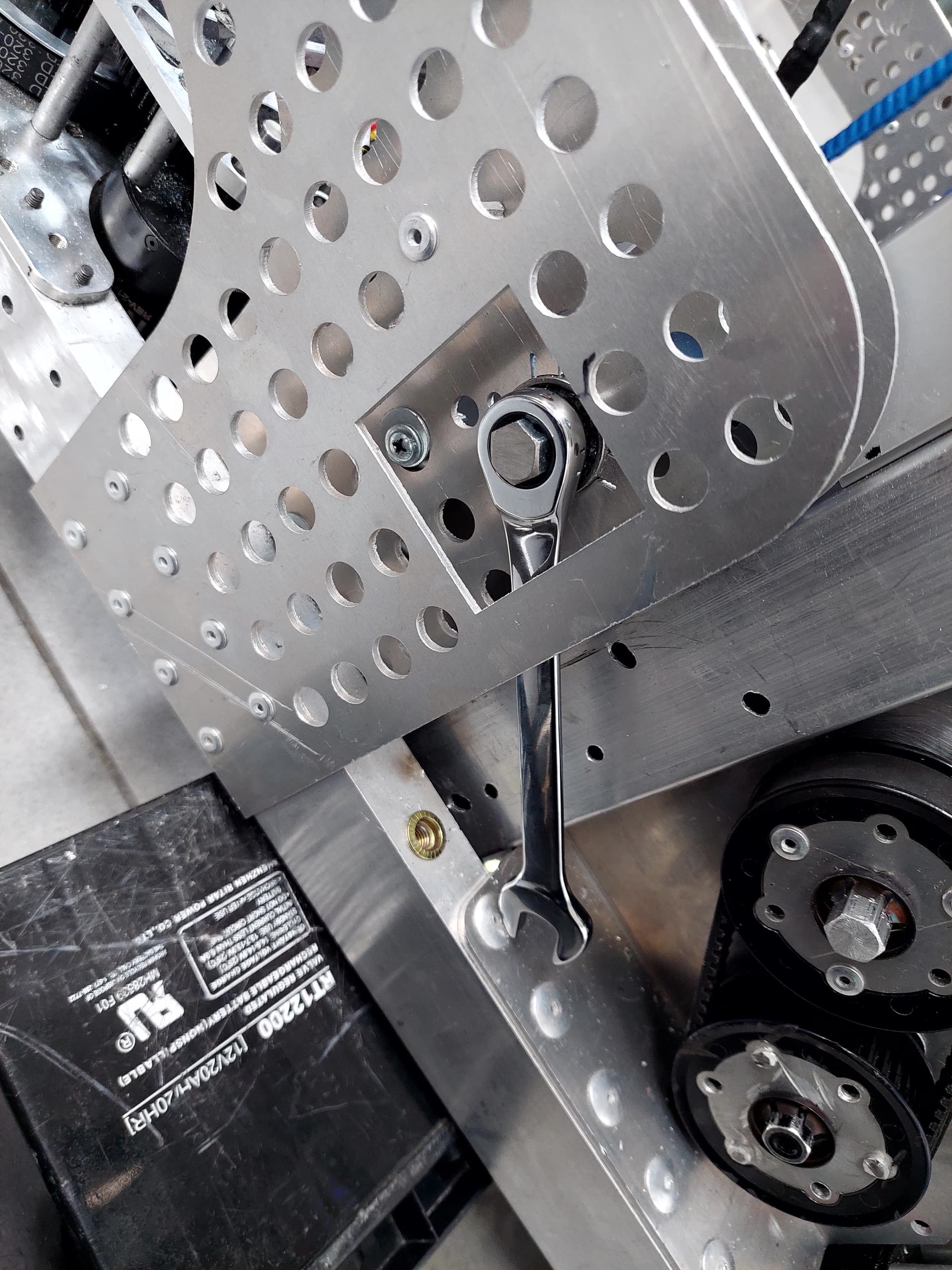

Brake mode will not stop a robot from falling after power is killed and there is nothing in programming that will prevent the robot from falling after power is killed you need to add a physical brake of some sort onto the mechanism there are many different ways this can be done, the simplest and quickest method would be to add an actual ratchet wrench onto the mechanism to prevent back drive, other options are a bicycle brake, or a ratchet and paw, which is the method we are using to prevent our motor from back driving.

Yes but in this situation, his gearing is not enough to accomplish that, and is most cases adding more gearing to it is not in the cards at this point into build season therefore a external brake in my opinion would be the quickest and Easyiest to implement and speed is not then sacrificed
I can suggest using a ratchet for locking the climb for cheap and easy implementation you can just use a ratchet wrench but then your climber can only be used only once per match which shouldn’t be a problem unless you miss the chain

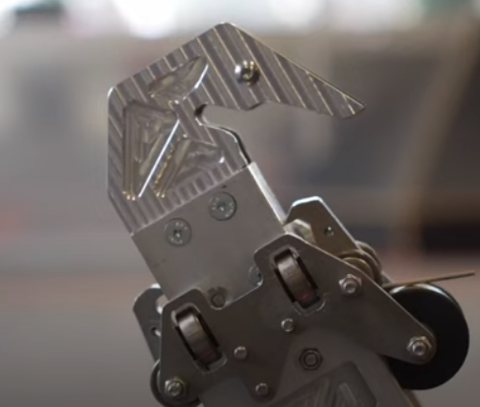

saw this incredibly simple and clever climber latch in Barker’s reveal!
barker-climb-latch
Might be easier than adding a ratchet at this point depending on what the mechanism is/how it works (if it’s on an arm or elevator that also does ten other things on the robot).
