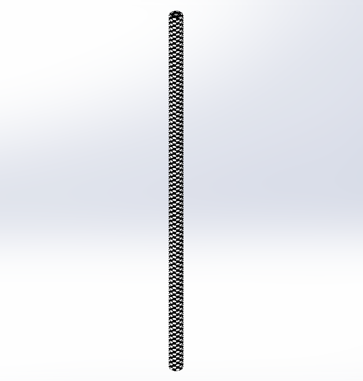

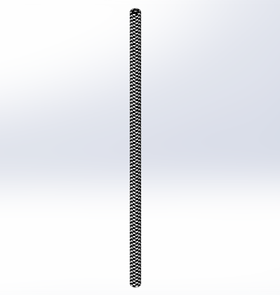

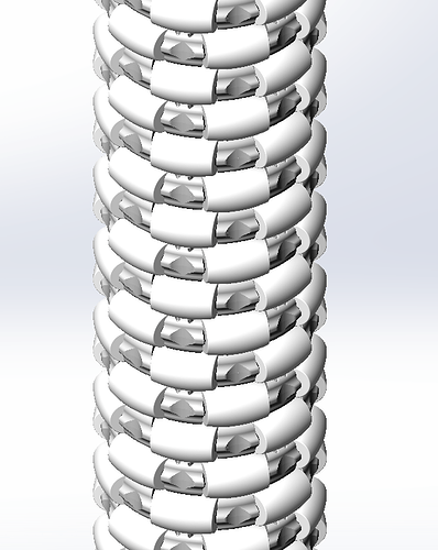

Climbing an Omni Pole
A pole made of omni wheels. How are you climbing this?
Fun fact: this is over $1600 of omni wheels.

How are you lining this up? Are they tapered and/or compliant so that driving forwards snugs them in?
Interesting, how so?
No restrictions were given. Therefore, ANY method is valid. Including a grappling hook. grabs drone Or a skycrane–well actually that last one isn’t technically climbing.
To be determined. But compliant is one possible option, tapered is possible.
Depends a lot on the mechanics. But I can think of a few ways. Wedges, for one, though they’d be rather small and thin. It may be possible to contact rollers on two different levels at the same time, in such a way that neither can move.

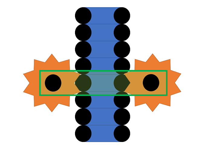

two hobbed climbing wheels with grooves that match the rollers, held tightly across the diameter of the omni wheels (with an over-center locking mechanism). The climbing wheels can’t “roll” [edit] “slide” down the omni rollers because doing so would push the climbing wheels apart. Spin the climbing wheels with a big ol’ gearbox to climb.

I think I understand the first two sentences but I can’t visualize this part. Could you help me out?

Brought to you in beautiful Powerpoint Vision:
The orange climbing wheels would be held by a motor/brake/ratchet. They can’t slide down the blue omni wheels because they are held together into the grooves between omni wheels by the green link.
