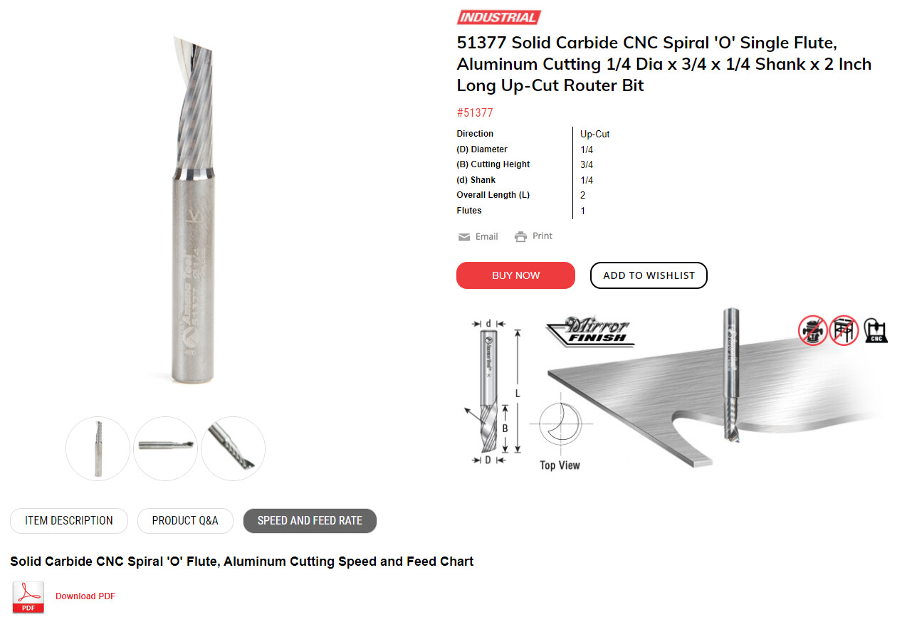

Feeds and speeds have a large effect on your cutting experience. People often try to be too cautious when first using a machine which can cause poor tool life, tool fracture, excess noise and slower machine operation. The important values are “Spindle Speed” which is how fast your bit is turning in RPM. “Feed Rate” which is how fast your machine XYZ axis move in inches/min or mm/min. “Chip Load” which is how much material a cutting edge is removing in inches or mm. And of course the bit information (diameter and # of flutes). Some combination of this information can be used to calculate the missing bits of the information.

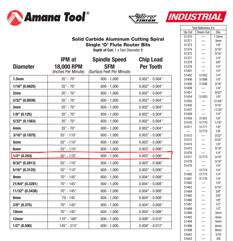

The place to start is finding manufacturers recommended specifications. For example if I use a bit from Amana tools I can find it on their website for example this bit. There is a tab called feeds and speeds and open the PDF.
here you can find some information on the bit as well as calculations at the bottom
I start by using the recommended chip load per tooth (0.003"-0.006" start on the safe side 0.003) and multiply it by the number of flutes my cutter has (1 flute) and multiply it by RPM which I can chose based on what I am comfortable with without going above max RPM if listed (I will chose 12000RPM). My calculation results in 36 inches per minute. The more comfortable you get the you may consider going to a higher chip load per tooth and or RPM if listed on spec sheet.
Depth of cut wont affect the chip welding issue but may affect tool fracture. A good place to start is same depth of cut as cutter diameter (1/4 bit cuts 1/4 deep). Softer materials such as soft wood may allow for deeper cuts while harder materials such as aluminum may require less.

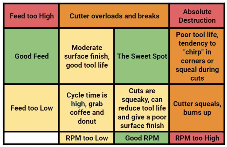

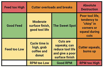

here is a good chart to explain this.
What causes tool wear. Smaller chip loads means the cutter has to form a chip more often which causes excess wear. The cutter doesn’t really wear much more by taking bigger chips but can break if the chips are too big for the cutter. Also if a bit gets too hot then it can ruin a bit.
Why single flute bits. The reason people like single flute cutters for CNC routers is because it can run at half the feed rate of a 2 flute and 1/3rd the feed rate of 3 flute and so on which makes it easier to hit the manufacturers recommended chip loads without requiring as ridged or powerful a machine.
Why cooling. Be carful about using active cooling to fix feeds and speeds issues. I highly recommend ensuring feeds and speeds are tuned first and then using active cooling to allow for higher chip loads (within manufacturers spec), deeper cutting, better tool life, lower noise better surface finish. Chip clearing is also important more so for surface finish.

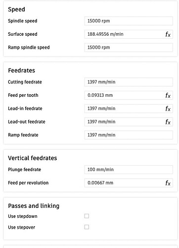

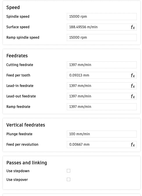

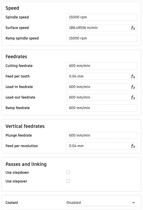

Heyo, 8177 Machinist here.
I wanted to be really conservative with our settings when cutting aluminum because
A - when i used a feeds and speeds calculator and used those settings, it snapped the bit(lack of cooling im assuming)
B - i’ve never used a cnc to machine metal before, so I didn’t know what to expect
Both scenarios were using a 1/8 single flute carbide endmill(straight, not spiral)
When running at about .01" doc, 15k rpm, 30 ipm, and 5 in/min plunge rate, it cut fine with regular wd40 spraying.
When running at the same settings but chaning the doc to .03," the bit snapped within a few passes.

15k rpm is SLOW for a router cutting aluminum. We run our 4mm(0.158 inch) single flute cutters at Max spindle speed of 24k and a high feedrate for us is 45ipm with WD-40 mist and airblasting the cutter for 0.090" 6061-T6. If we didn’t have air we’d probably cut that down to 15ipm. No oil mist but did have air, we would drip oil periodically and probably run around 20-25ipm. Air makes a HUGE difference and oil helps too.
Would you cut 3/8" Polycarb in one pass with a 4mm single flute endmill, or is that too much?
Also, straight flute is normally only used on wood in a hand router. You really want some spiral angle; helps chip clearance and reduces shock loading.
ah ok good to know. I only had it at 15k cause i wanted to generate as little heat as possible and i was under the thought process of lower rpm = less heat generated. Thanks!
