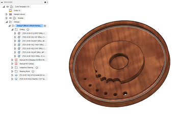

CAM Templates:
We call this the Cyber CAM template and are still messing around with it. It should have reasonable speeds and feeds for all of the Cyber Tool Library tools. It includes:
  • Spot-drilling all holes less than 1/2" (we might make this smaller in the future)
  • Auto-selecting and drilling of all of our drill sizes in the tool library
  • A printed note in the UI to screw parts down after the drilling operations
  • A manual stop in the program to give the machinists time to screw the parts down without stopping the program
  • Adaptive clearing options for all endmill sizes (with “rest machining”)
  • Bearing bore options for 3/8" endmill (pretty much our most commonly used endmill for removing lots of material)
  • A 2D contour with a 3/16" endmill to cut parts out of their plate
  • A 2D contour with the spot drill (what we currently have for chamfering parts, not ideal)
You can find and copy our latest CAM template here. Again, my suggestion would be to cater this to your own teams needs. This is a fantastic video going over how to create, save, and use CAM templates.
I follow the belief that deleting CAM operations you don’t want is quicker than adding ones that you need which is why this might seem like a lot of different options. I also used “rest machining,” which assumes material has been removed from the next smallest tool down. If you are only using one size endmill make sure you uncheck this option on your adaptive clear routines.
To make all of this I modeled a simple part that has pretty much every typical feature a standard 103 robot part may have. I then used that part to make a simple CAM template.
