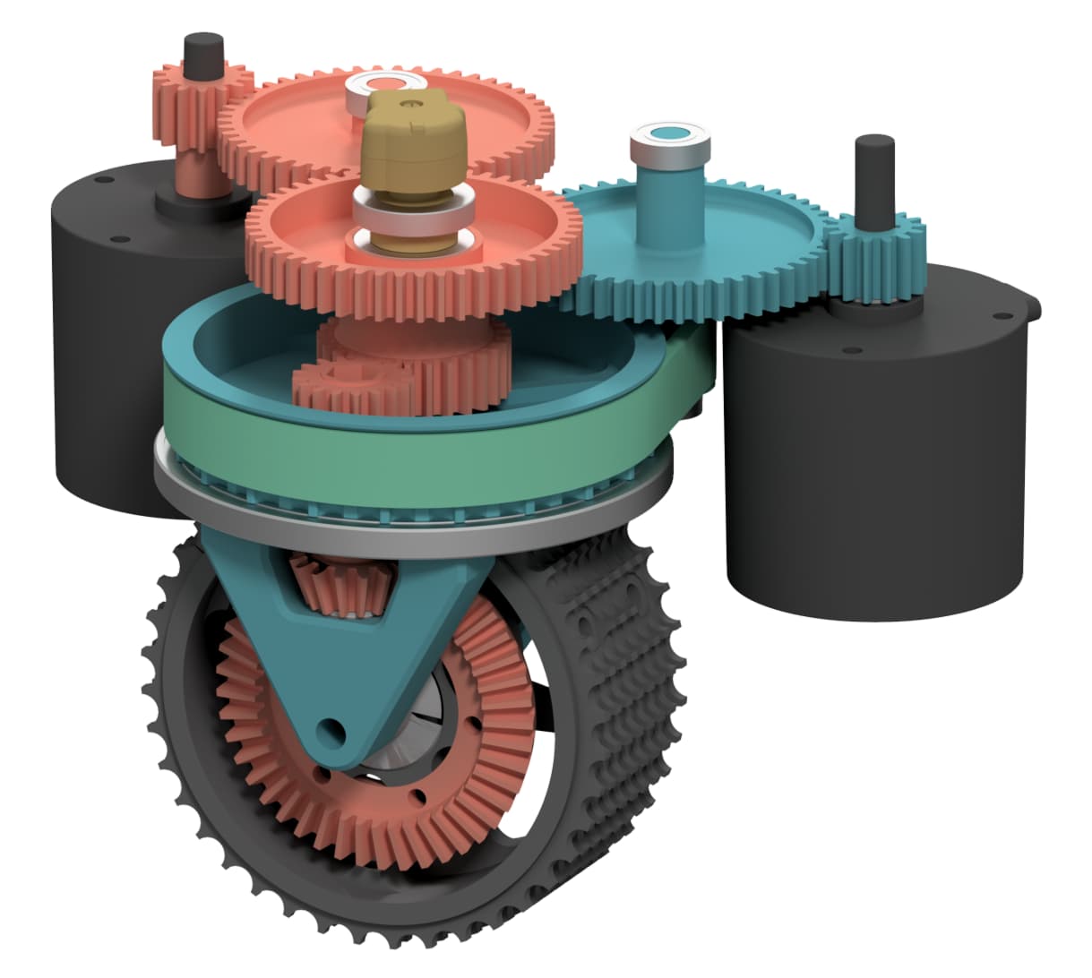

Firstly, here’s the MK4:
MK4 Swerve Module – Swerve Drive Specialties
As you can see, there is one system used to control the direction of the wheel, and one to determine the speed.
The left motor is the drive motor (the motor that determines the speed of the wheel), and the motor on the right is the turn motor (the motor which controls the direction of the wheel).
The turn motor starts with a pinion gear (the spur gear on the output shaft of the motor), which rotates a spur gear. The spur gear has a shaft which leads downwards. At the end of shaft is a pulley. The pulley then spins a timing belt (the teal object) which rotates the large pulley in the center of the module. Two legs protrude from that central pulley, and the wheel and its axle rest on these two legs using ball bearings. You can think of the pulley, legs, and wheels, as the thing the turn motor is trying to rotate.
For the drive motor, a pinion gear is used to spin another spur gear which is located in the center of the module. That spur gear is in the center so that when the wheel and central pulley rotate, this spur gear is still in the center of the pulley and not at a different angle to the wheel. The spur gear under it is part of this spur gear, and they’re created as one singular piece or object. What this means is, when the higher spur gear rotates, so does the lower one. When it rotates, it spins the spur gear next to it, which has a shaft leading down to a bevel gear. This gear is used so that it can always stay at the same position on the pulley and more importantly, at the same angle as the wheel, while maintaining a mesh with the spur gear in the center of the module. The bevel gear spins the ring gear or rack which is set on the wheel, causing the wheel to finally spin.
There is also an encoder located in the center of the module. Utilizing bearings, its shaft passes through the red spur gear without interacting with it, and measures the blue pulley underneath. By doing this, it can tell the computer what position/direction the wheel is facing at any given time.

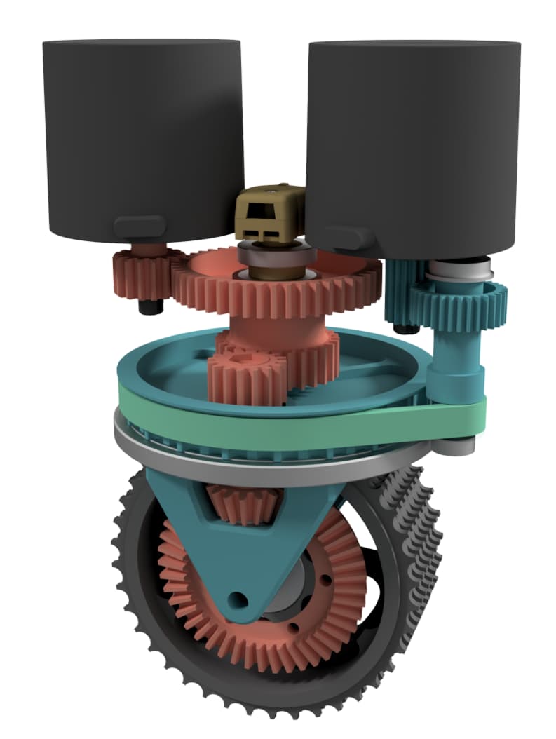

Next, the MK4i:
MK4i Swerve Module – Swerve Drive Specialties
Both systems begin the same: with a pinion and spur gear. The motor on the left is the drive motor, and on the right is the turn motor.
The spur gear which interacts with the pinion on the drive motor turns the red spur gear located in the center of the module. From there, it’s the same as the MK4 in that the spur gear beneath it is actually part of the higher spur gear. It then rotates another spur gear, which has a shaft leading downwards through the pulley, which has a bevel gear at the end that spins the bevel ring gear or rack.
The turn motor rotates a spur gear using its pinion gear, and the spur gear has a shaft leading downwards. The shaft has a pulley at the end, which rotates the central blue pulley using a timing belt. Like the previous module (the MK4), it rotates the wheel using the same design.
An encoder is used on this module as well, and functions exactly the same as the MK4.

Anyways, this was just meant to be a guide for those new to swerve. I’m still learning and created these myself so that I could expand my knowledge on swerve. If I got anything wrong, please let me know, and the same goes for questions as well.

What does the yellow mean on the MK4is? It seems like the gears would make more sense being blue/red. I sort of skimmed so I might have missed something.
This is incorrect. There is a part that mounts to the top of the blue gear that has a hex sleeve that fits into the through bore encoder. This allows the encoder (yellow in your pic) to read the absolute position of the module.

Thank you for the explanation, that was slightly confusing to me when writing as I didn’t understand why they chose to measure speed. That makes a lot of sense though.
For that module, my CAD software wouldn’t allow me make them different colors since they’re the same CAD model. I’m still looking into that and will update when I figure it out. I thought it wasn’t too confusing, so I decided to leave it in for now.

What did you do the render in. In SolidWorks as an example, you can change part appearances at the assembly level, which means you could change one of the gears to a different color and the other gear that is the same part file will remain whatever color it currently is.
Of course if you rendered in some other software, then there may be another way or there may not, YMMV.
I use Autodesk Inventor. There’s likely a pretty simple way of doing it, but I’m still on the search.
It seems like I can’t edit this post, but here’s the updated picture of the MK4i:
