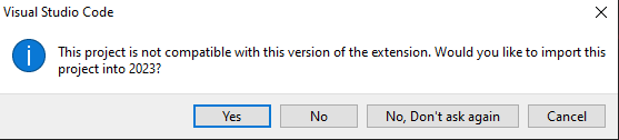

Hey guys, I am trying out some code, but I am coming across an issue and VSCode won’t stop giving me this issue ;-; I can’t figure out why it keeps saying “The method run(() → {}) is undefined for the type Drivetrain”
Here is my code for Drivetrain.java:

I’m guessing you want to find the class with the run method you’re looking for in it and then do import static ... to use run() in your code without specifying the class.
run(Runnable) is present in SubsystemBase, so that shouldn’t be giving you the problem.
Could you post the entire context of your error message? i.e., where is it appearing, what is the surrounding text, etc?
It’s just the run() keyword itself. It’s happening in subsystems/Drivetrain.java. It says: “The method run(() → {}) is undefined for the type DrivetrainJava”
Yes, but where does the message appear?
Does it appear under PROBLEMS at the bottom? Is it giving you a red underline?
Does it appear under TERMINAL at the bottom, and if so, could you post the entire contents of that tab?
Ohh yes PROBLEMS tab with red underline
Wait is it possible that it is because the project year is 2022?
Yes, run(Runnable) was not added to SubsystemBase until after the 2022.4.1 release. You should probably upgrade: WPILib Installation Guide — FIRST Robotics Competition documentation
Ohhh ok thanks!!! If that’s the case, should I restart my project?
Opening it in the latest version of WPILib VS code should automatically prompt you to update the project
YUP IT WORKED! I’m so happy lol
