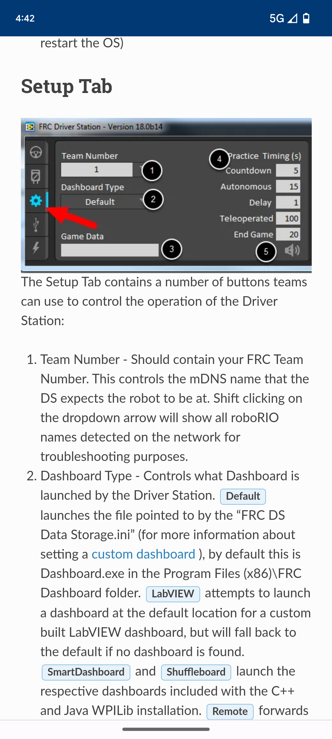

One thing @Molly_Connolly has pointed out to me several times I’ve made this error when using a new laptop as a driver station - make sure within the settings of the FRC Driver Station your team number is set. It should be the 3rd or 4th tab on the left of the DS window. (I don’t have it open in front of me).
I am pretty sure that our team number is the same everywhere

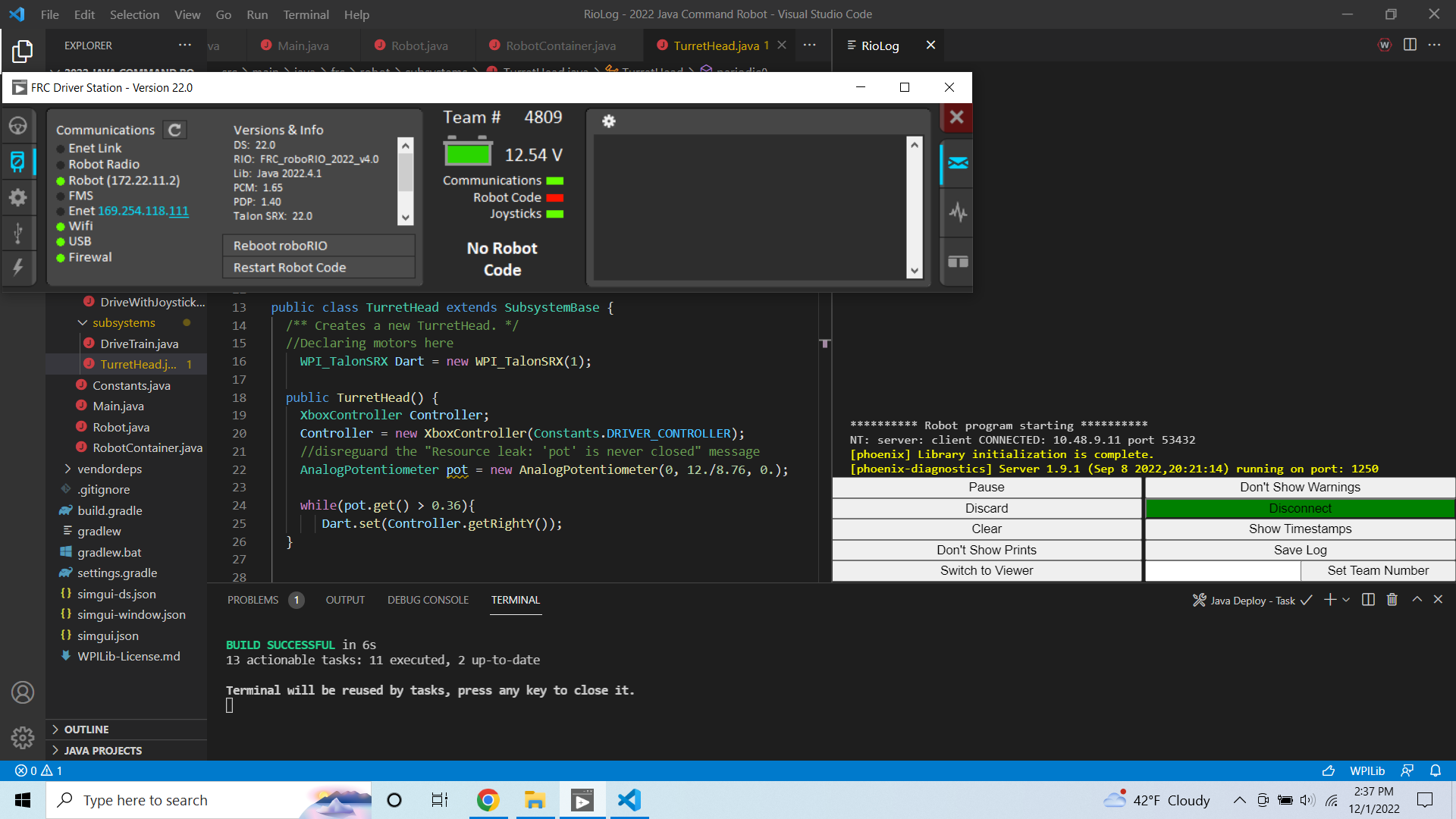

Here is the screenshot of everything. I do use VSCode and DS on the same laptop. I was able to reach the Web dashboard through USB. I am sure that the team number is set correctly. I am noticing that the communication light on the roboRIO is solid red now.
Thanks. It looks like you are not successfully deploying your code.
I notice that VSCode is reporting one problem. Have you checked that out?
Can you show us a little more of the terminal log in VSCode above the "BUILD SUCCESSFUL? Sometimes VSCode isn’t doing the build you think it’s doing.

I have checked out that error. It’s a resource leak for our analog potentiometer. I was informed that it didn’t matter based on the situation. I have triggered the build using shift + F5 to deploy it. I have used the WPILib symbol in the top right corner to find and try the deploy and build options.
So it might be that your deploy works, but the code crashes “immediately” on the Rio. If you know your way around Linux, you can log into the Rio with SSH and see if it is running. I don’t remember how to figure it out beyond that.
The program is starting, as shown by the RioLog window (“Robot program starting”). The most likely cause is there’s something causing the code to hang (or less likely, crash) when the main Robot class is being created or in robotInit(). The template only tells the DS code is running after those two things happen (at which point it also prints out “Robot program startup complete”). We’d have to see your full code to help trace this further.

Actually, re-examining your screenshot, I think the issue is right there–the while loop in the constructor. The constructor isn’t going to finish until that while loop condition is satisfied. In general robot code should not use while loops / waits for conditions, and that line in particular looks like it’s misplaced anyway (why is that operation being done in the constructor?)
I think the issue is related to a while() statement in a subsystem. I found that when I replaced it with an IF statement, there is no issue and I can enable the robot in the DS. I believe that how I have the while() statement set up is possibly causing the code to crash immediately and not be detected by the DS.
