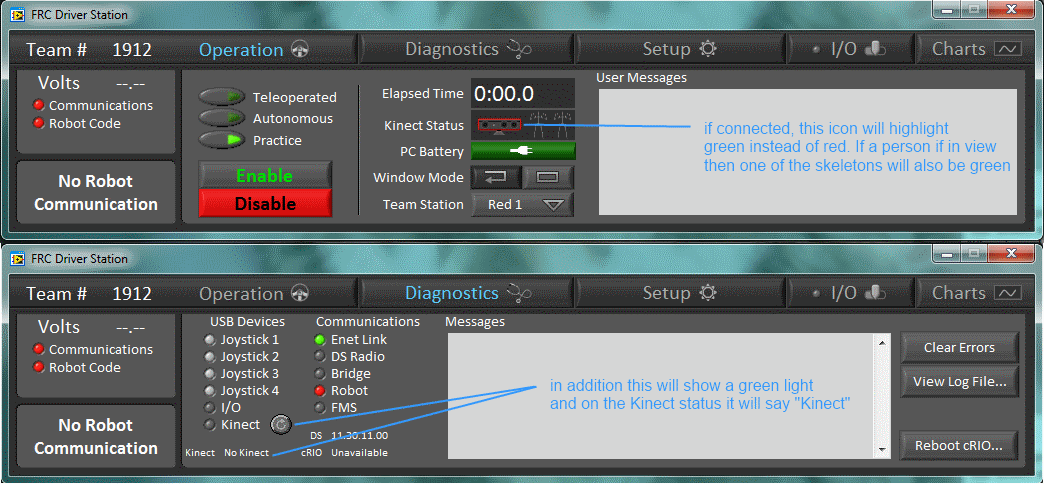

Is there any code in LabVIEW that shows that the kinect is attached to the driver station? We want to implement kinect for championships, but this information would be very helpful for us.
Your best bet is probably to use the player output (I don’t recall which VI it comes from, I think Kinect Header) and checking if it is 1 or 0.
Ill try that. That’s a good idea

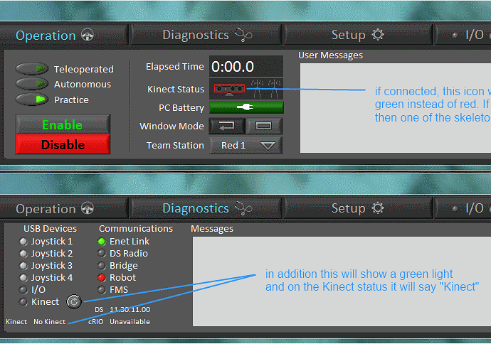

When you plug the Kinect’s usb cable in from the field your driver station will show it connected. The screenshots attached explain further.
