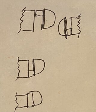

I agree. The bumper rules cover horizontal support requirements but they are quiet on how much of the height of a bumper must be supported. We have definitely built robots that look like the upper left robot in my drawing below. Now imagine that as a high-bumper robot impacting a low bumper robot with a low frame perimeter. A little flex from each and I think the high-bumper robot is going over the low one (esp if the bumpers are minimum height so the overlap is minimized.
I think you state it well, but you need to interpret G417 along with G418. But this is one of those rule sets that gets interpreted if different ways during a match. I am not criticizing referees that are trying to get it right. There is a lot going on and it is impossible to see everthing.
As an RI and an experienced mentor this is one of the hardest parts of inspections. I pass bumpers and supports that meet the minimum requirement, but I would never would accept on my team. As an RI I enforce rules as written. I only comment if the team is open to suggestions.

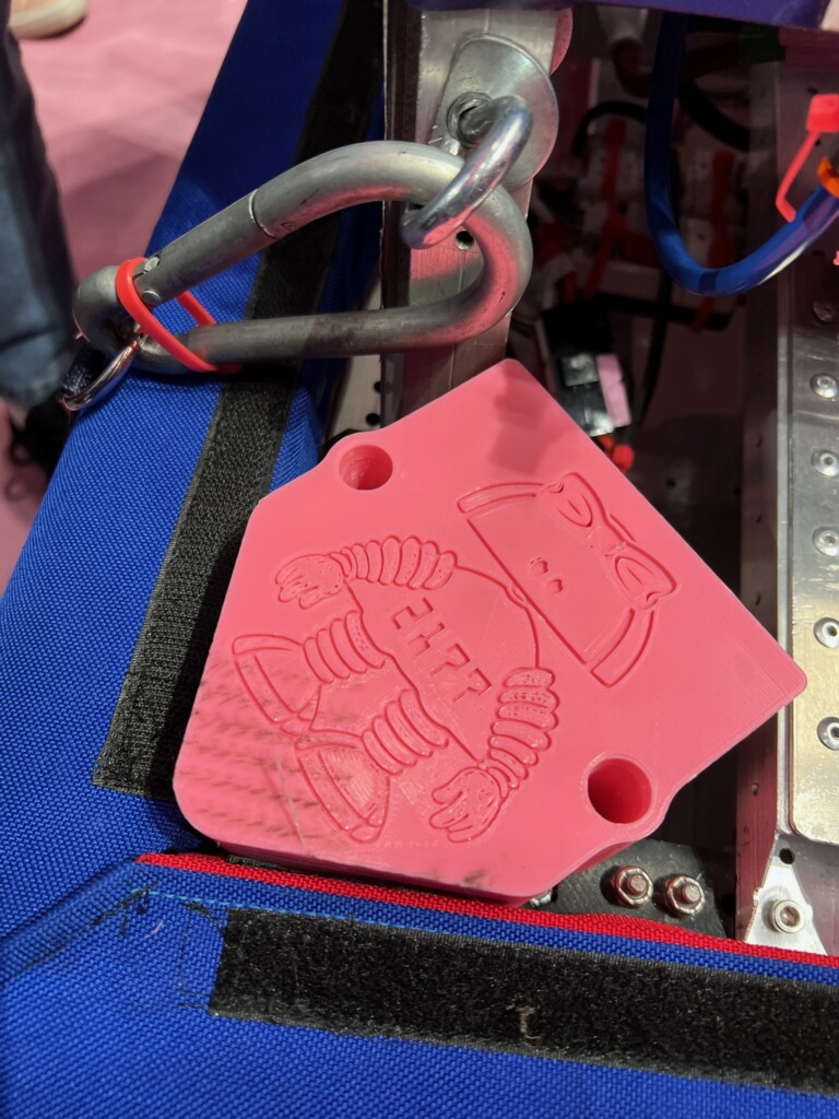

That’s a good picture of my concern. I think @Skyehawk mentioned it on a different thread & I’m interested in more discussion of the risk & how to mitigate. I’m going to recommend at least polycarb corner guards to protect our swerve modules & motors.
I recommend going a little beefy on swerve guards. This was found after a match last year - protecting both the sides and the top with something fairly rigid can save you from a big headache!
OnShape link to last year’s robot, where you can find these MAXSwerve covers - modifications are needed to accommodate the increased height of Kraken/Vortex over Neo! Onshape
