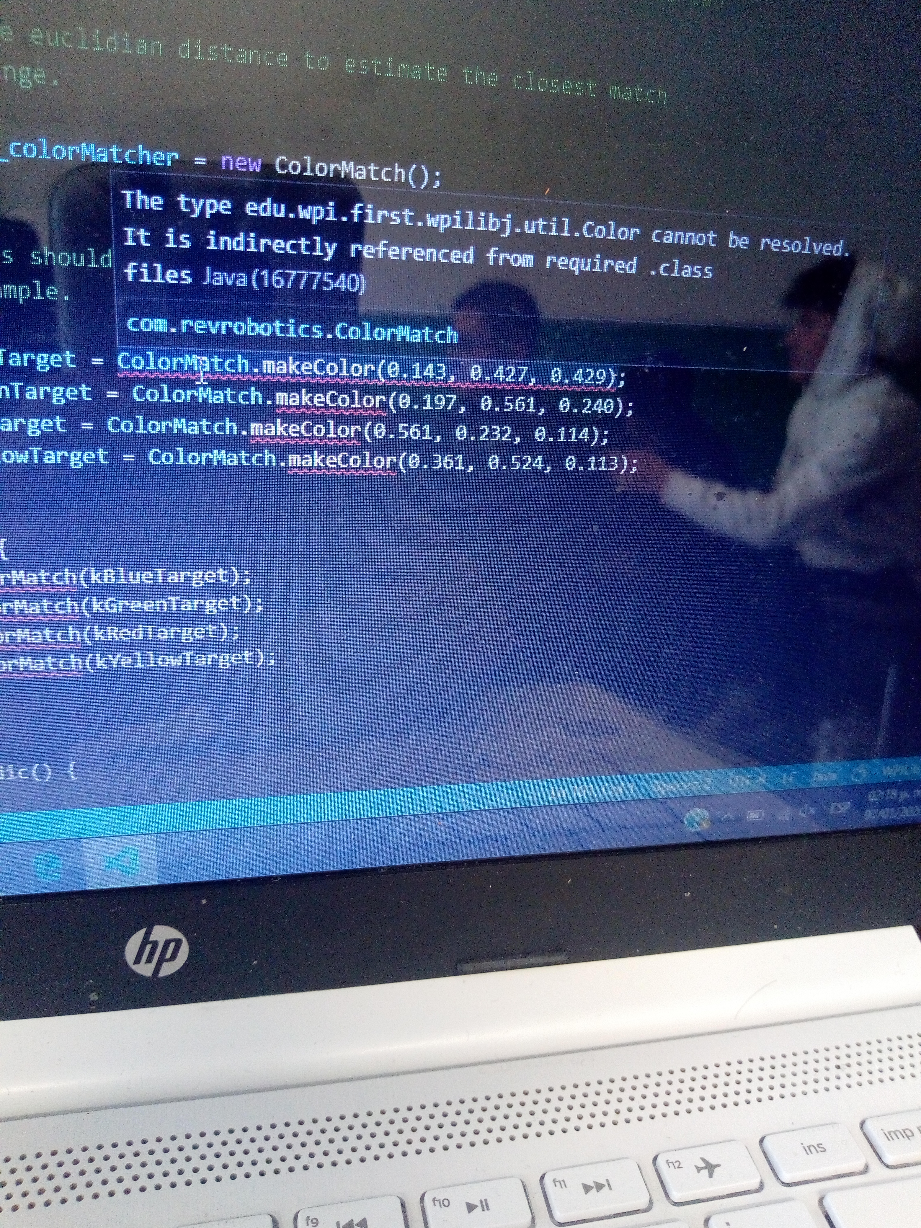

Hi guys, today I’m trying to program the new color sensor that is on the kit of parts, but I’m having this trouble,
Did you import your project into 2020, or create a new project with the 2020 install? Adding that library to a 2019 project will not work correctly.
Ohh okey, but where could I get it??
You can install the 2020 version of WPILib by following the instructions here: https://docs.wpilib.org/en/latest/docs/getting-started/getting-started-frc-control-system/wpilib-setup.html
