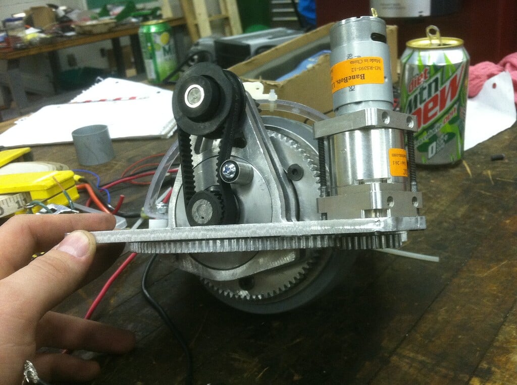

Has anyone tried a Colson on a swerve module?
Team 40 used them the last few years in their modules.
I would think there would be a wear and tear advantage over the treaded wheels with the side loads.
The awesome swerve drive done by 3928 this year utilizes Colsons.

Team 228’s 2010 Swerve Used ‘Cut’ Colsons, Team 148’s 2008 swerve used Colsons, Along with 3928 (2012) and Team 40 (2011) as already mentioned.
