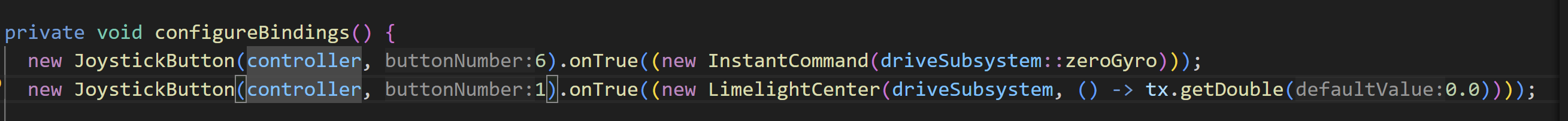

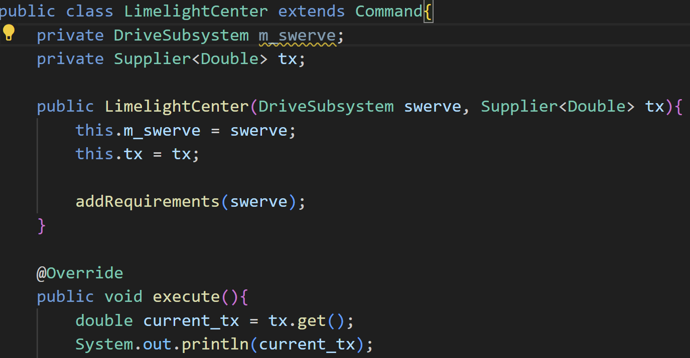

I am trying to print limelight.tx values to the console while an x-box “b” button is being held down, however, values are being sent constantly. What should I do to fix this?

Your println is in the execute of a command that (I assume) has isFinished() { return false; }, so yes, its going to print continuously until that command completes or is interrupted.

We were just using the print.ln statement to make sure the command was running properly (which it isn’t). We realized we never added an end() function, but after adding it values are still printing continuously. The command should complete after the print statement, so we’re not sure why it is not. We also did not have an isFinished() function at the time of posting (we tried both with and without one after adding the end() function, both times had the same result).
Commands don’t inherently know how long you want them to run, so you have to tell them. That’s what the isFinished method does. If you only want it to run through once, you can have that method simply return true. Want it to run forever, return false (this is the default). Otherwise you can add whatever boolean end condition you need.
Change onTrue to whileTrue
You could also try changing .onTrue to .whileTrue so it has an interrupt. Additionally you can make a refrence to the command instead of making a new one every time.

new JoystickButton(m_driverController, 9)
        .whileTrue(m_limelightCenter);
