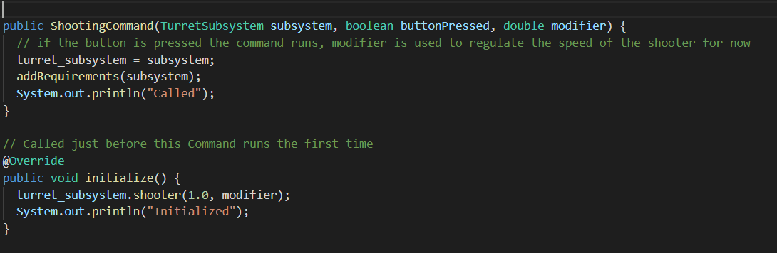

Hello, we are having problems with command based programming. In our code, we are calling the shooting command from robot.java using a lambda, however it never reaches the initialize function within the command.
It prints the first string, and passes the requirements, but never prints initialized or calls the shooter functions from the turret subsystem. Any suggestions?
The lambda-accepting bindings wrap the lambda in an InstantCommand and run that on trigger activation.
So, your code is simply running an InstantCommand that instantiates a ShootingCommand and then exits.
You shouldn’t need a lambda for what you’re trying to do. The lambda expression as written essentially runs a command that creates an instance of “ShootingCommand” and then exits. If your goal is to directly run “ShootingCommand” you would want to write:
btn.whenPressed(new ShootingCommand(turret_subsystem, oi.l1(),0.8));
If the reason you are doing this is because you only want oi.l1() to be evaluated when the command actually runs, you could consider passing it in as ‘oi::l1’ instead which will pass the method into the constructor instead of the value that method takes. This is called a method reference. You can then call that method during initialize:
btn.whenPressed(new ShootingCommand(turret_subsystem, oi::l1,0.8));
Another option if method references are too daunting is to just pass oi into the command and call oi.l1() in initialize.

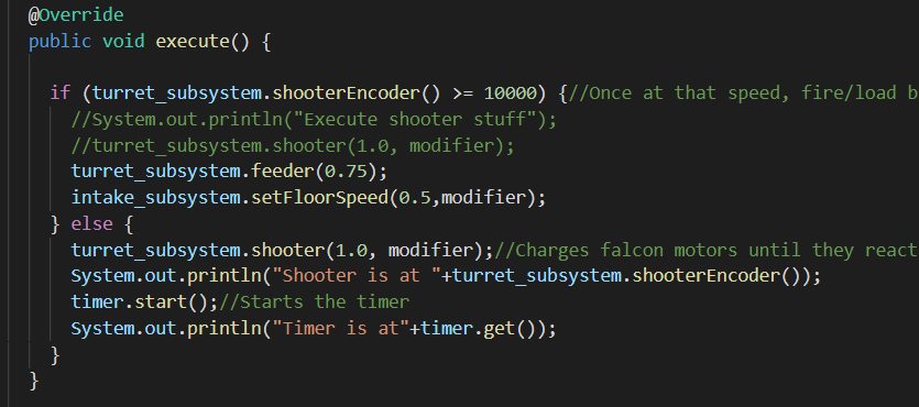

Now the command unexpectedly ends itself once it reaches the shooting part;
i think you are calling intake_subsystem but you haven’t passed that to ShootingCommand when you initialized it.

Where is intake_subsystem in your command being initialized/passed to the Command. I only see you passing turret_subsystem to your command from your RobotContainer.

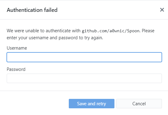

Thanks for the suggestion gixxy, but github just reallllllllly hates me for some reason, not allowing me to push or pull from remotes due to a authentication bug.
Do you have 2-factor authentication setup on your account? If so, you need to use a “personal access token” instead of your password. https://help.github.com/en/github/authenticating-to-github/accessing-github-using-two-factor-authentication

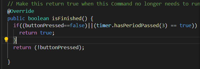

Anyways, now the command doesn’t seem to stop; here’s the finish code

Alrighty, so the shooting command doesn’t seem to stop, either due to the timer giving weird values or the buttonpress not returning that the button has stopped being pressed.
Assuming you’re referring to this command: https://bitbucket.org/A0wn/spoon-test-commands/src/937d453bd5765a2f998d463c43dc9942521c4915/src/main/java/frc/robot/Robot.java#lines-126
buttonPressed will ALWAYS be true right now (https://bitbucket.org/A0wn/spoon-test-commands/src/937d453bd5765a2f998d463c43dc9942521c4915/src/main/java/frc/robot/commands/ShootingCommand.java#lines-82), but that doesn’t explain why the timer isn’t ending. I’m sure there’s a logic failure somewhere, but I’m not seeing it at quick glance. I’ll have to take a deeper dive into this unless someone else beats me to it.
Again, I do recommend reading through the command-based docs and considering starting a new project then copying your logic into that format. If nothing else, it’ll be MUCH easier for other teams or CSAs to help you with any issues you might experience at your event(s).
